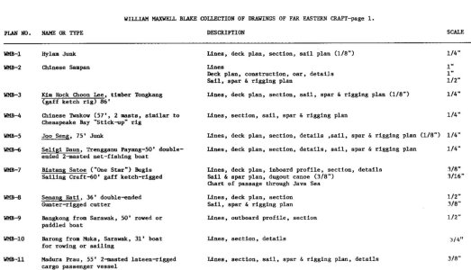

rather than just a posting where to find plans let's take a close look at a collection of plans. Th8s is a catalog dating back 30 or 40 years ago from the National Maritime Museum UK
click on the image for a larger readable view
the above list is the Admiralty collection and are the original drawings which means first off you have to understand what the plans are and how to convert them to modeling plans be it plank on bulkhead. plank on frame or a lift hull.
Bob brought up a good point what if the GRACIE S is too much for a beginner or what if a builder wanted to do a different vessel?

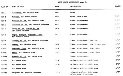

ok then here is a PDF file of every vessel and every drawing in the Historic American Merchant Marine Survey
to provide work for unemployed skilled or "white collar" workers. These projects were intended to provide work which was both useful and appropriate to the skills and experience of workers who were not suited for more traditional work programs involving manual or outdoor labor. The specific goal of HAMMS was to undertake a national survey of watercraft, in order to document the design and technical evolution of vessel types significant in America's commercial maritime history. This was to be accomplished by making measured drawings of existing vessels, ship models, and builders' half models; by making a photographic record of significant vessels; and by compiling written data about vessels.
The HAMMS program was in existence from January 1, 1936 to October 15, 1937. The Smithsonian Institution served as the official sponsor of the Survey and received all the documentation produced, thus augmenting its already significant National Watercraft Collection. Unlike other WPA projects, HAMMS was administered directly from Washington by its Director, Eric J. Steinlein, who coordinated the survey work of six regional directors. Despite its national mandate, the Survey actually was limited to the eastern seaboard, the Great Lakes, and California. Furthermore, the types of craft surveyed and the level of documentation varied considerably within the six regions. During the course of its existence, the HAMMS program conducted over 166 surveys and produced over 400 sheets of line drawings of ship's hulls, rigging, and details.

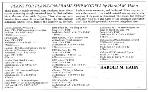

There are modeling plans available which are drawn as plank on frame but can be converted to plank on bulkhead or lift construction
