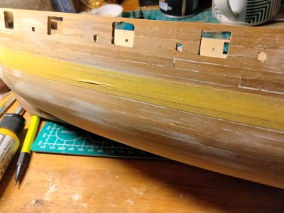

The hull is sanded, ready for paint and masking tape placed.
When watching online builds some of the builders use primer. Most don't.
I will be using Mission Models Ochre and Tamiya Flat Black. Should I primer firs17438153600445630285535995618113.jpgt

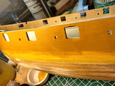

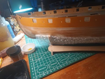

Here's the results after using a second coat of Model Expo Yellow ochre hull paint. I'm happy with it.IMG20250405082447.jpg
