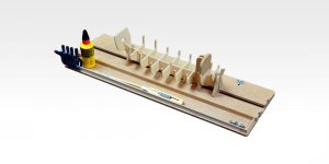

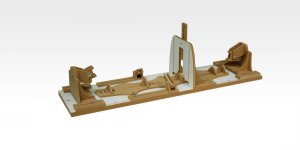

I’m tying to decide between the two Jigs.

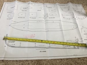

The keel on my Seguin build is about 21in/54cm long, but measuring from the top of the stem to the overhang at the stern the length is 25.5 in/65cm. The specs for the smaller jig are 60 - 80cm, with the ideal length being 60cm. But it looks like the larger jig allows for more versatility.
The other caveat is the keel height. I don’t see a measurement for the keel depth on the jig. The Seguin plan shows 3/8in/10mm for the keel height. The frames/ bulkheads have an 3/32in/4mm indent for mounting on the keel.
The larger jig seems to me to better for what I’m trying to accomplish. It looks like the keel would sit up on the jig vs. being clamped into the slot on the smaller jig.
After re-reading the large jig Instructions several times I finally stumbled on the link for building the smaller jig.
I’m still trying to figure out which jig to try, or maybe design and build my own version.
