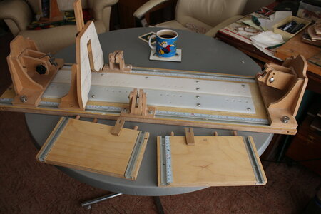

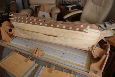

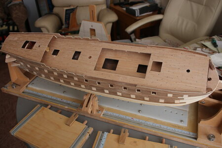

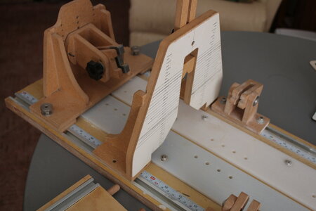

I built my own based on this one, using 9mm & 18mm MDF, T-track & T-bolts, star knobs, & 6mm PTFE (for the keel clamps). Plus I made a pair of extensions for very big ships, eg. Montanes. Set in the appropriate orientation the hull can be rotated 360*. I find it ideal for holding the hull rock solid when cutting gun ports & the first few rows of upper planking, but not for the rest, I prefer the hull inverted on my work surface.
Did you forget the pic?:) Love to see it…
Photos attached. The ship can be turned thro 180* either right way up or inverted. I guess, depending on ship size, & full vertical set up of the clamps a full 360* 'roll' could be achieved - haven't tried that yet.

By the time I've got to the masts etc, the hull would be finished & mounted on her stand pedestals screwed up in to the hull. I only use the rotation when wworking on the planking etc.

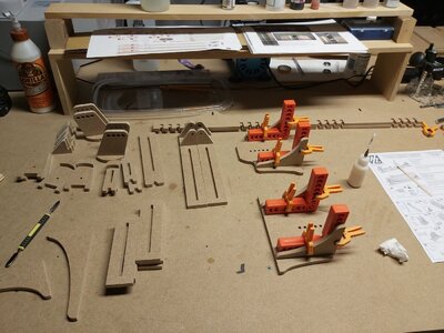

Hi, I finally got mine and start the built of it. It was very easy to remove the piece with a good knife and very little and gentle sanding let the finition with very good appearance.
Thanks for all the infos provided here to help us.
View attachment 328285View attachment 328286
I am looking forwrad to see this jig complete - and maybe you can tell us your first impressions and early experience using it....
