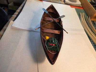

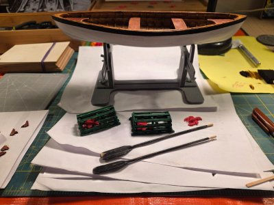

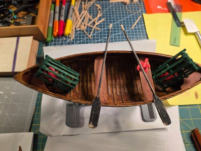

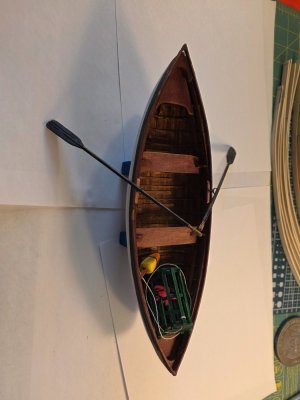

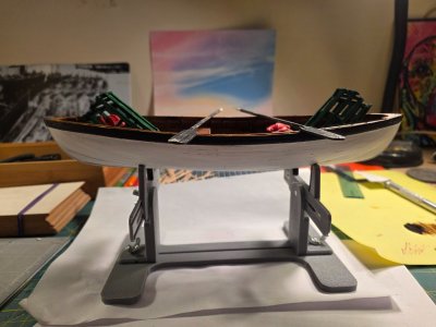

Making progress on the Midwest Maine Peapod. First time trying to "weather" the oars and the lobster traps (I made 2 because I may do a diorama with the traps laid out to sea). I also tried to weather the inner hull but did not want to distract from the planking. Next step is to build a stand, put string handles on the oars, and add the rub rails and rowlock blocks. Painting the buoys then I should be done. This is my 4th wooden ship build and I'm loving it.
I just noticed your support stand. Can you post information on this, it was a new one for me.
TIA Ignatius
TIA Ignatius
Allan - Here's a link to the boat stand I am using from Amazon.com. I've seen it available from many different distributors and at a lower price than $26. I find the cambered edges on the frame holding bars to be its best feature for boat model building. Funny...after this build I am going to upgrade to a stand with measurement markings to help be more accurate during construction. I hope you find it useful. /Ignatius
Sigvetan Stand for Model Boat kit Berth jig Stand Building aid Tool, for Most OF1/350-1/700 (Grey-3D Printed)​
Your peapod looks great! I built one in the past and it was a lot of fun. Nice job on the lobster traps! The lobsters are a cute add on. To weather the lobster traps you may want to add a bit of gray streaks. When I did mine I went more with a gray and bare wood, the salt water really beats these things up.

Thanks Rob! Can I ask what paints and/or stains you used for your Maine Peapod? Im trying to stick with water-based stains for most of it, but I may need to use acrylic paints for the buoys. My spouse hates the smell of turpentine and my work space is in the attic above our bedroom.

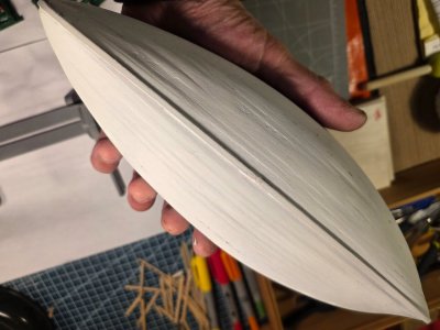

I used Tamyia acrylics white for the exterior and tan for the interior. After some sanding I do use a couple of coats of sanding sealer (others use shellack) before I apply the paint. I find acrylic paints tend to raise the grain and it looks fuzzy. The sanding sealer does have a smell. The Peapod was airbrushed, but I have hand painted with good results. When I stain I use minwax stains which do not have a strong odor.

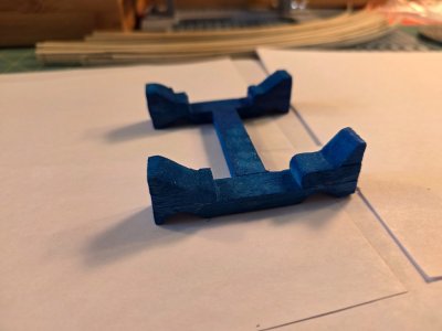

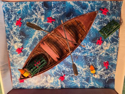

The Maine Peapod is complete! Despite screwing up the hull planking (I planked bottom-up instead of top-down), I think it turned out well after faring and staining the hull. The one visible flaw in my build is the extra 1-2/8 inch of mahogany strip where the rub rails meet at the bow. I also should apply some graphite to weather the ropes. I may go back and fix them sometime down the road but I'm eager to move to my next build, a cheap wooden version of "La Real" a Spanish oared galley. The first pic is a silly diorama with mini-lobsters that I created for my friend, who I am trying to interest in starting a modeling club at our church by gifting my boat to him. I fabricated the stand out of balsa wood. I estimate this build took me between 90 and 100 hours of work -- not sure if that is good or bad for my 4th wooden boat build. Thanks to all of you who gave advice on weathering and your encouragement!
