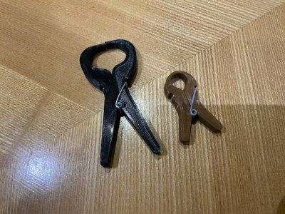

Just purchased the circle cutter from Dispae for cutting masking tape for airbrushing my models. It’s beautifully designed. I will use it for those tricky areas to mask up.
I've purchased a few Dispae tools in the last year or so from the local hobby shop. A little costly but well made and well designed. Looks like I need this one too Bryian ROTF.

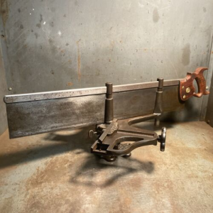

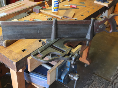

As anybody who has ever tried to cut perfectly matched miters for model cases, picture frames, interior trim, or any other mitered corner knows, it's a lot harder than it looks to get a perfectly matched mitered joint without any edge chipping or tear out. Small stuff can be done successfully with a fine-toothed blade on a Byrnes saw if one takes the requisite care in setting up the angles. For anything larger, a shooting board and a sharp block plane will do the job as long as one is careful to come at it from both directions and not cut past the far end and chip the edge. Then, too, it takes some care to get the lengths matching exactly which for me often means more than one try. (So I always cut my case frames before I buy the glass cut to size from the local picture framing shop.)

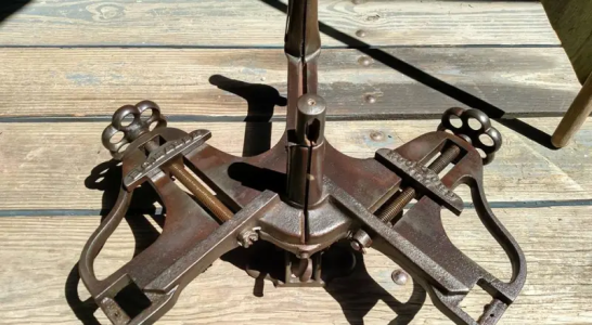

Full-size table saws and powered miter saws are much too rough and often not accurate enough to do the job without requiring a lot of trimming to get the angle perfect without any edges chipping. Hand saw miter jigs are a bit better, but not by a lot. There is a tool for solving the problem, save for edge chipping. That is the H.C. Marsh Miter Machine (later Stanley-Marsh #100.) I have been fortunate to have come across two of these no longer made combination miter sawing and assembly jigs over the years, amazingly with their accompanying Disston 26" and 22" backsaws, respectively. I found one in an online auction and another at a garage sale serendipitously a week apart. I bought the second one because it was too good a deal to pass up and will permit me to glue up two corners simultaneously, thereby cutting my "glue setting" time in half. One much appreciated unique feature of this miter saw and vise, which accommodates work up to 4" in width, is that it rotates 360 degrees and tilts 90 degrees which permits moving the joined corner to a convenient angle for sawing a kerf for a spline or drilling for a dowel or for nailing. I bought one of these machines and its saw for $25.00 USD, the other for $50.00 USD. They're running around $300.00 to $350.00 on the tool collectors' market, less their backsaws which can run as much as $250 and up for Disstons in good condition. Not anywhere close to being an essential for ship modeling, but very handy for building wooden framed glass model cases, picture frames, and mitered interior trim. If you come across one for cheap, buy it!
H.C. Marsh Miter Machine (photos from internet:)

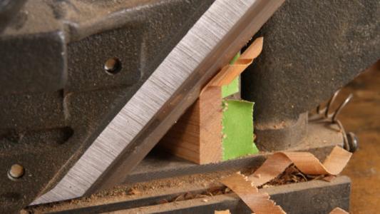

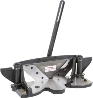

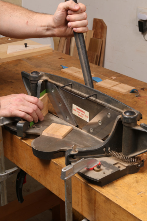

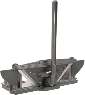

The Marsh Miter Machine was marketed primarily for picture framing and, back in the day, they were standard equipment in every commercial framing shop. They were accompanied by the Lion Miter Trimmer, a cast iron lever-operated shear which shaves the mitered edges of workpieces up to 4" by 6" at any angle desired between 45 degrees and 90 degrees, leaving a perfectly smooth finish with no edge chipping. Invented in the late 1800's, the Lion Miter Trimmer is still manufactured today and sold under the labels of various specialty hardware retailers such as Grizzly, Lee Valley, and Highland Hardware, being marketed not only for use in picture framing, but as a miter shaving machine for any mitered joints within its capacity. I stumbled upon one in nearly new condition at the recycling resale center at the local dumps the other day and was able to buy it for $50.00 USD. They retail for between $300.00 USD and $350.00 USD. I'm looking forward to using this beautiful hunk of cast iron and steel in the near future. It will come in handy for making ship model cases and any other miter work that comes along.
See: https://www.highlandwoodworking.com...an/miter-trimmer-woodworking-tool-review.html for demonstration of use and application details.
Lion Miter Trimmer, photo of Highland Hardware's currently produced copy of the original:

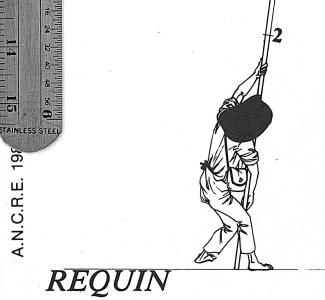

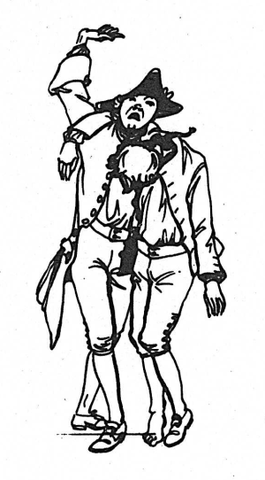

Just got these off eBay for an absolute bargain. Currently it would cost over $200 with tariffs to buy these new. I got them for $125. All 23 of the plansets are complete and in pristine condition. It also includes the translation booklet. Plus, I think, an old school ANCRE catalog from back before they were on the web.
I'm currently in the process of scanning them.

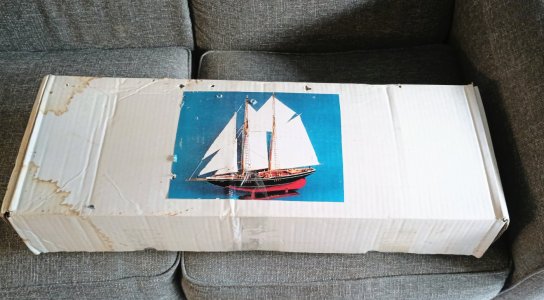

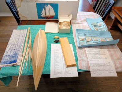

I purchased this Bluenose ii model kit form a Salvation Army thrift store today for 30 bucks.
It was made / sold by the Bluenose ii Preservation Trust that looked after her from 1995 until 2005. Not sure if the maker or if all the parts are there or not but we'll see.IMG_20251121_151212826_MP~2.jpg
I know. Still not sure who made it but it's a solid hull kit.
Neil
I can't be sure because just about every ship model kit manufacturer made a Bluenose or Bluenose II model at one time or another, but if I had to guess, I'd say the parts and packaging, particularly the plans, parts list, and instructions (such as they are) look like what the Marine Models Company (AKA True Scale Models) of Halesite, Long Island, New York was putting out between 1945 and the late 1960's or early 1970's. I am also not sure, but believe it is possible that their line was acquired by Model Shipways of Bogota, NJ shortly thereafter.
Just a word of caution: Many kit manufacturers, Marine Models among them, used lead castings for their fittings during the period when this kit was apparently made. Lead can corrode (oxidize) in acidic environments, causing the lead castings to turn to powder and, consequently, any paint or coating on them to flake off. (See: https://cdn.wildapricot.com/278718/...l030Jj5Ue19dlFrw__&Key-Pair-Id=K27MGQSHTHAGGF)
If the castings are lead, as might be indicated by surface "chalking" apparent on them or by testing with readily available "lead test kits" sold in paint and hardware stores, I would recommend not using them. Replacement castings can likely be sourced from kit manufacturers presently selling Bluenose II kits of the same scale. If not available, the existing lead castings can be used as pattens for silicone molds and replacements case in alternate metal alloys or epoxy resin.
