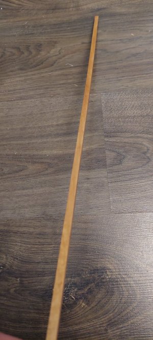

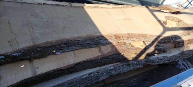

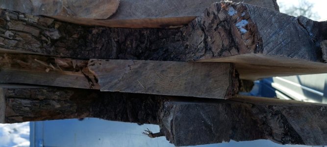

The wood is now in lumber stage. It has a lot dirt stains and I need to cut it on smaller planks. After planing it will show it's true colors. This pear(I guess) is just typical european pear from polish garden. It has dark brownish color which can be magnified with oils or other substances

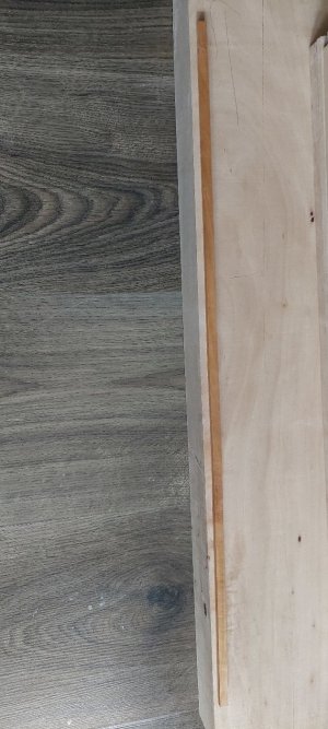

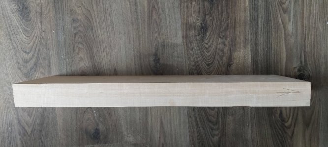

I'made keel for L'Ambitieux from similar type of pear. Un-oiled looks like this
The color of the oiled wood is lovely. Nice and warm.

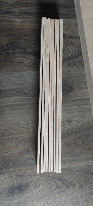

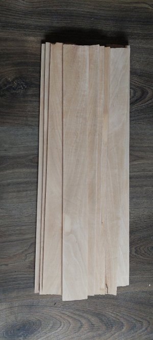

I noticed some warpage in your panels. That happened to some of my billets as well even though the lumber was well seasoned. It seems the ripping and planing process releases some stresses and boards end up 'not flat.'
There are some irregularities in thicknes. The little planks were cut to 8,5mm and then planned to 7mm on proxxon. Distorions on planks and wood strip is between 0.05 to 0.15mm depending on quality of cut. You can notice come differences in wood color in some places- I didn't polish the wood strip at all.
