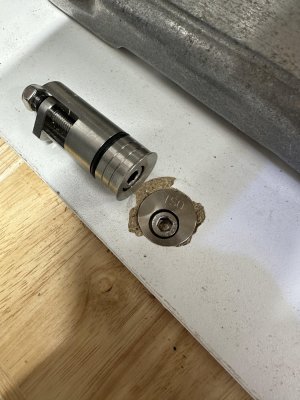

This is what I use:
They go through the dog hole and then you tighten the allen screw to attach it tightly. These are by TSO. Of course, they require not only a hole in the base of the tool mount, but also holes in your workbench as well. :) This one is holding my tabletop drill press on the bench. But I also have the same mount for a tabletop sander and a drill press that uses my Dremel tool.
Note, there are multiple sizes of dog holes and they have to match the bench dogs. :) Here is a link where you can get them:

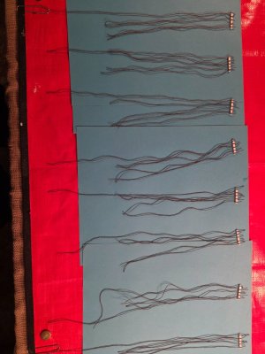

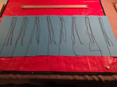

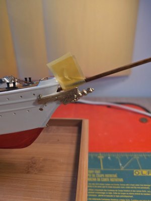

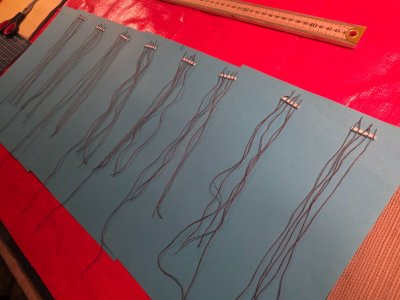

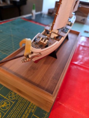

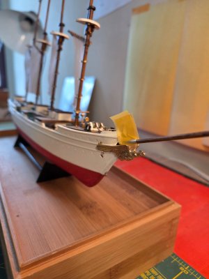

Progress pics of the Juan Sebastian de Elcano / Esmeralda. I decided to go with the Esmeralda with the Golden Bird figurehead carrying the lone star of Chile. That way I don't have to repaint the hull!
Got into fabricating the 8 sets of shrouds and I'm finding that CA superglue is not your friend when building shrouds. I might be on the lookout for an eyedropper to apply the CA glue to the shrouds.
Tomorrow the shrouds go up. Then the 3 jibs and foremast stay sails. And the bowsprit rigging and mounting the figurehead. Will probably start sewing the square sails onto the foremast spars if I have time.
