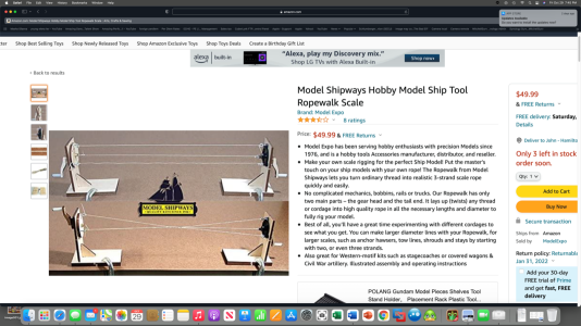

I use the rope walk machine from Model Shipways with great success to make left hand rope of any diameter I want.

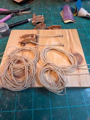

I haven’t had any problem with tension or stretching. For finishing the rope, I simply draw it through a diluted solution of acrylic paint.Hi David, that sounds good, but someone mentioned something about nylon, specifically that it can lose its tension due to heat or temperature fluctuations. And here in Florida, one thing we have plenty of is heat! Haha. What is your experience with this? Is that true? Another question: I know it looks very similar to the real thing, but how do you go about dulling the shine on the thread? Or do you just leave it with its factory finish? Thanks in advance for your prompt reply.

Maybe I'm just lucky, but I haven't experienced any problems with the nylon changing tension. After I spin a new rope I give it a good tug to tighten the fibers. Perhaps that helps.Hi David, that sounds good, but someone mentioned something about nylon, specifically that it can lose its tension due to heat or temperature fluctuations. And here in Florida, one thing we have plenty of is heat! Haha. What is your experience with this? Is that true? Another question: I know it looks very similar to the real thing, but how do you go about dulling the shine on the thread? Or do you just leave it with its factory finish? Thanks in advance for your prompt reply.

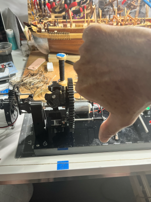

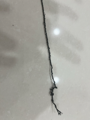

Let me know your honest opinion about that mi friend!! You can see part of what got ruined behind the machine, to the left! And that is just a small percentage of everything I had to throw in the trash. Furthermore, I'm talking about a wind machine not the vertical one. That is my opinion regarding the PL4-3 that I bought, on which I lost over $300.

All the ropes shown here were made by spinning up multiples of 0.016" nylon thread.

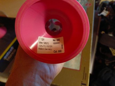

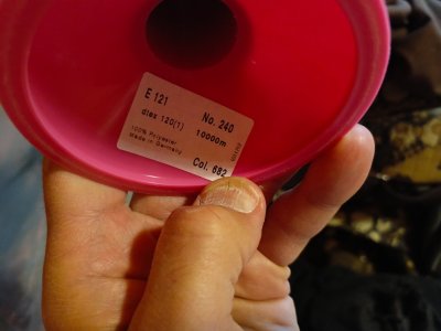

I'll probably do the same—I'm already looking into the necessary supplies to make my own! because I ended up losing my money.I didn't like the Domanoff machine either, ended up making my own. I use Amann Serafil, beautiful polyester. Good luck.
Hi Bob.I feel your pain! As noted early on in this thread, operating a planetary rope making machine does have a learning curve. There's nothing wrong with the Domanoff PL4. It is the most capable rope making machine on the market, particularly with respect to its ability to lay up four-strand rope with the essential fifth central core strand and its small space requirements. That said, perhaps for reasons of international language differences or the manufacturer's over estimating their customers' sophistication with the mechanics of rope making, I have to say that their instructional materials are perhaps less than adequate for the unsophisticated operators of these machines. With knowledge of the mechanics of rope making, anybody should be able to recognize and diagnose the problems most initially experience with the planetary machines. (Don't ask me how I know this!)
I won't attempt to write a compreshensive instruction manual here, but I will pass on some observations that I hope will be of assistance to you and others. Your experiences aren't unique, by any stretch of the imagination. (Been there. Done that. Got the tee shirt!) Some of my suggestions may be already well-known to you, but I'm stating them now because I have no idea of the extent of your experience at the moment.
Study the mechanics of how rope "works" and understand it before doing anything else.
Understand the importance of the direction of the lays in making up a rope. Understand "left hand" and "right hand" laid rope, also sometimes referred to as "S-laid" and "Z-laid" rope respectively. Understand how the tension created by the twist in the strands made in the rope making process works to form the rope and hold it together. Google is your friend. Read everything you can find online about rope making. There is a lot of material in this forum. Model Ship World also has extensive discussions of rope making, including a lot on the Domanoff machines, some of it directly posted by Alexi himself. (There is a section in their "rigging" sub-forum that covers it all. At the moment the MSW server is down, but expected to be up soon, or so they say.)
Pay particular attention to the brands and types of thread that others use with good results and don't deviate from those.
Some report good results with nylon thread. I have no direct experience with nylon thread, but I can say that, generally, synthetic thread does not take dye well, so a scale rope maker will be better off working with thread that is colored the color they want to use on their model in the first place. Natural fiber thread is easier to dye. Synthetic rope is made of various "plastics" and plastic, being non-absorbent, must be colored either in its initial manufacture or by coating it with some sort of color. Natural fibers are absorbent and take dye readily. All threads have their limitations for use in making scale rope. The major issues are stability and stretch due to environmental conditions such as heat and humidity, and other susceptibility to age-related deterioration. Some thread material will hold together and not unlay as readily as others because its fibers are less smooth and benefit from the increased friction as the twisted fibers bear on each other to hold the rope together. Other synthetic fibers are "smooth" and will "slip" and so not yield as acceptable a rope when twisted up.
Learn from others' mistakes! Use what works. The cost of thread should not be a consideration. When purchased in large spools rather than small amounts packaged on the usual small spools for home sewing machine use, the price-per-foot is much, much cheaper. Not all threads are the same. Not only are there many sizes and colors, but also different "finishes" resulting from the fiber material, the tightness of the thread twist (the thread's "hardness") and its reflective qualities (glossy or matte.) For all these reasons, I recommend you only use the Gutterman "Mara," "Scala," or "e121" 100% polyester threads so many have found excellent for scale rope making. Gutterman has a wide spectrum of available colors and you can similarly "go to school" on what others are using for various purposes. The Gutterman "Mara" line has been approved by some European museum curators and restorationists as suitably archival (100+ years "lifespan.") At one time, natural linen thread was the "industry standard," but this thread is no longer readily commercially available in sizes and finishes suitable for scale rope making, being replaced by synthetics and synthetic blends in the general thread making industry. Not all colors, types, and package amounts of scale rope making threat are available in fabric stores! Don't even bother looking for them there. The best place I know to obtain Gutterman thread for scale rope making in the colors ship modelers require in the large "industrial" quantity spools is WAWAK Sewing Supplies in New Jersey. (See: https://www.wawak.com/search-results/?Brand=Gutermann&q=Gutterman+Mara&r=true)
The direction of the thread's twist dictates the direction of the rope's twist.
If your thread is right-hand twist, the rope will be left-hand twist. If you then make rope with the resulting left-hand twist rope as its strands, the resulting rope will be right-hand twist. If you try to lay right-hand twist rope with right-hand twist thread strands, it's not going to work. Most thread is right-hand twist. Most rope on period sailing vessels was right-hand twist. This creates a problem for those who wish to have their scale rope twisting in the historically accurate direction. Most don't bother because it's so small a detail that it isn't a major flaw. However, if one wants absolutely accurate period scale rope, they will have to use left-hand strands to yield right-hand rope.
A novice rope maker is well-advised to master laying up rope of three single strands before progressing to multiple part strands.

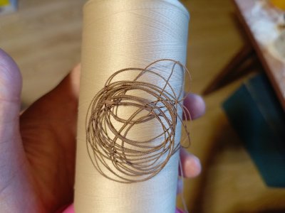

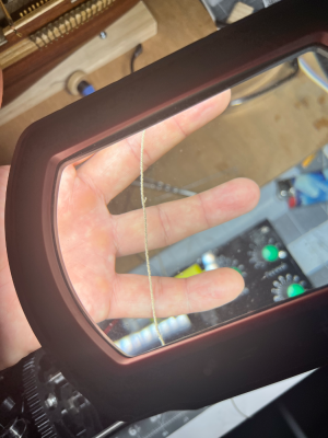

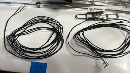

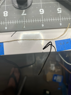

Your first picture above appears to show six threads presumably twisted in three pairs. There's more than enough things to go wrong laying up single thread strands without doubling the risk! Planetary rope making machines don't handle multiple part strands very well at all in my experience. It's too difficult to get the tension equal in all the threads at the same time. (More about this later, but equal tension is critical to successful planetary rope making.) There are various ways to control the diameter of the rope to be made. Multiple thread strands is one way, but better suited to rope making machines which do not draw thread suppled from bobbins. Other ways to determine diameter are to vary the diameter of the threads that serve as the strands and to lay up thin rope and then use that rope as strands to make a thicker rope. Keep in mind as well that bobbin-fed planetary rope making machines have upper limits to the size of the strands that they can spin into rope. The PL-4 works fine for the scale rope normally required for commonly used scales, but when one reaches the upper limits of the machine, it will let the operator know! Also, the thicker the strands loaded on the bobbins, the shorter the maximum length of rope made becomes.
The thread strands must be wound on the bobbins with equal tension on each bobbin.
The resistance on the thread strands on the bobbins as the thread is pulled by the take-up spool must be equal on each bobbin.
The result you are getting in the rope in your second picture posted appear to be the result of uneven tension on both one of the threads in a strand wound on the bobbin and uneven tension on the strands coming off a bobbin.
To get a bobbin wound with even tension, it really must be wound on a bobbin winder. All sewing machines have bobbin winders on them. If you don't have a sewing machine, the easiest thing to do is buy a stand-alone bobbin winder. These start at around twenty-five dollars. Amazon has lots of different models. You don't need anything fancy. These all have an adjustable tension device which ensures constant tension to the thread as it is wound evenly on the bobbin and an automatic shut-off feature when the bobbin is full of thread. Wind your bobbins full to start so you don't have uneven waste when the shortest one runs out! Another advantage of these machines is that they load a bobbin in seconds.
The tension on the thread strands coming off the bobbins as the machine runs is also very important. This ensures an equal twist and lay-up to all the strands in the rope. On the PL-4, the bobbin tension is adjusted by the knob on each bobbin axle. There is a felt spacer on each bobbin axle and adjusting knob pushes the side of the bobbin against this felt pad to create friction which adjusts the tension of the thread as it is pulled from the bobbin by the tension of the rope pulled by the take-up spool on the machine. This adjustment must be made by "feel." pull a bit on each strand when setting up the machine to be sure the tension on each is equal before tying off to the take-up spool to make sure they are good to go.
Once the strands are set up through the machine to the take-up spool, you will need to test at slow speed to adjust the relative rates of the planetary wheel and the take-up spool. The take-up spool must turn at a slow enough rate to permit the bobbins on the planetary wheel to spin the strands sufficiently to create the tension which causes them to lay-up tightly enough against each other. The cuntline (the "seam" between the strands of the laid-up rope) should be at an angle of about forty-five degrees from the centerline of the rope and this is how you know your lay is tight enough, which is to say that your strands have been twisted tightly enough before the rope begins to form when it comes through the guide on its way to the take-up spool. The bobbins must spin quite fast to do this. The point at which the three strands "kink" to press against each other forming the rope can be adjusted by adjusting the speed of the planetary wheel and/or the speed of the take-up spool. Admittedly, this will take a bit of practice and experimentation. It's sort of like patting your head with one hand and your stomach with the other while walking and chewing gum, but a little bit of practice and you'll have it down without much trouble. The important thing is that the strands are twisted tightly enough to have the rope forming together at the point where it comes out of the planetary wheel guide on the machine. (Dominoff's instructional videos show this but unfortunately don't tell you what it is you are looking at!) Read Dominoff's posts on the MSW rope making section for more detailed information about adjusting the "rope forming point" and the adjustment of the rope making exit guide on the planetary wheel for more on this subject. The twist of the strands is key to successful rope making. Most all of the issues folks encounter result from a lack of equal and sufficient tension on the strands from unequal tension in winding the thread on the bobbins, unequal tension on the bobbins as the thread comes off the bobbin, and/or insufficient twist imparted to the strands.
Once you have the PL-4 properly adjusted to make good rope at slow speed, you can incrementally increase the speeds of the planetary wheel and the take-up spool, taking care to maintain the relative rates of speed of each. You will seen that adjusting the speed of the take-up spool with cause the point at which the strands "kink" into rope to move and that adjusting the speed of the planetary wheel will cause the tightness of the lay-up to vary.
Rope made with synthetic thread generally needs to be "heat cured" after lay-up to prevent unraveling.
Synthetic (plastic) thread tends to have a "memory" and want to unravel when rope made of it is cut. This unraveling can be eliminated by heating the line after lay-up. This "cooking" very slightly "softens" the "plastic" so it "forgets" its original form and when it cools is "set" such that it stays put and doesn't unravel. You will find the exact recipe for this cooking in the MSW rope making posts. The rope should be secured from unlaying by tying a seizing of thread around one end before taking it off the planetary wheel and then carefully unwinding it from the take-up wheel and seizing it at the other end so it can be handled before being "cooked" without risking unravelling. I don't at the moment remember the temperature and time in the over for this sufficiently to feel secure in stating it with absolute certainty at the moment, but it's something like 120 degrees Fahrenheit for five minutes or something like that. Oven temperatures can vary, so one has to be careful. It's in the nature of the material that if the critical temperature or time is exceeded, you'll end up with a puddle of melted polyester which is not good. Some recommend applying heat with a hair dryer instead of baking in the oven. I haven't tried that, but plan to do so in the future. When treating the rope, it should be wound around some sort of mandrel so that it does not stick to itself or end up with kinks "cooked" into it. I've wrapped it around an empty can to good effect. The advantage promised by the hair dryer alternative is not having to deal with the oven and the can and the ability to better monitor the effect of the heat applied as you go. Heat treated scale rope should not unravel at all thereafter, although some slight tendency to unravel due to rough handling in use may remain, so a drop of shellac or other cement is probably advisable when rigging with it, although some report no need to do that at all.
Keep records of your rope making successes.
When you've set up the PL-4 to make acceptable rope of any given size, write down the type and size of the thread and the type and size of the rope [e.g. "1:48 scale 1" diameter, right hand lay, Gutterman Mara (size and color)] plus the settings of the control dials on the PL-4 on an index card and tape a short length of the rope made to the index card. Keep the index card and the rope made loosely coiled in a Ziploc plastic bag. If you need to make more in the future, you won't have to do as much for the set up over again.
I hope this will be helpful to you or anybody else. This is stuff I learned the hard way. Rope making is a somewhat arcane art. Now you know some of its "secret handshakes." Try to set your frustration aside and give the PL-4 another chance. It's a complex tool, but not at all an inherently bad one.

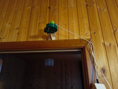

I’m using a more traditional rope walk machine. And getting excellent results of it and it’s easier to use. Heaps easier and critical the rope walk rope making machine. Including the vertical one you mentioned can wind in more than 1 yarn into a thread which the PL-4 lacks the ability to do as a conventional rope walk machine does.
After all the traditional rope walker has been used to make ropes for some 400 years from what I can find in my research. There is a reason for that. And if you ever get the chance to try one you will see for yourself why.
