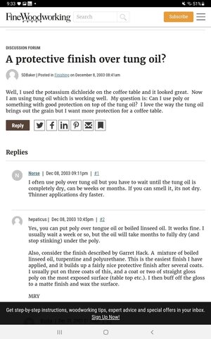

Actually, you can use poly over tung oil after it is fully cured.
See attachment

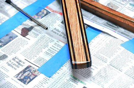

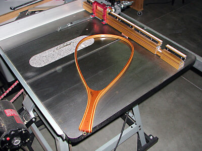

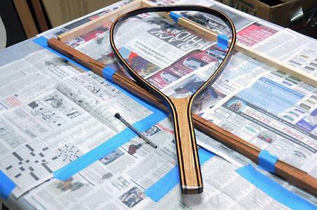

I prefer Danish Oil (Watco) followed by Spar Urethane and use it on fly fishing nets that see alot of water. I let the oil fully cure for 3 days before coating with the urethane. I haven't tried it on a model ship as yet. I will be using Danish oil on the model I am currently building. I have never used tung oil on any wood items I built.
