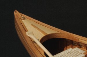

If you can cut your own strip wood, it is easy to substitute with any other species: keep in mind that you need something that will bend easy for the planking and ribs.
The rest, like the decks and and other parts, can be made from thicker stuff shaped by hand.
For example, in this case, the deck was made from thicker lumber. Cannot really see from the photo, but there is a slight curve up following the center line. It can make for an attractive detail that is easy to do with a scraper or by sanding to shape. When finished the edge towards the inside of the canoe can be sanded down to required thickness. Realistically, the deck could be fashioned from 1/4" material if you want to spend the time working the accentuated shape.

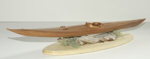

Gilles, one thought I had was a Kayak canoe, top enclosed except personal opening, with some kind of cloth sleeve attached. Maybe a hatch in front and back top deck like modern ones have. A shorter narrow version, maybe 3/4 size of 17" size.
Or you can wait for my next construction guide :) and go with a full wood strip kayak.

One in the making::
