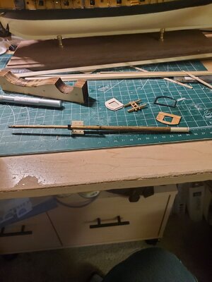

I purchased the practicum for the Rattlesnake mast and rigging. I just started using it this past weekend for the masts. Initial impression: well worth the money. It took a lot of guesswork out of the build. I also purchased the second CD that only has pictures, I don't think that was worth the money because there are a lot of builds with pictures to be found.
I think that by the time I finish rigging the Rattlesnake, I probably wont need to buy another practicum on rigging for my next ship.
