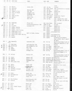

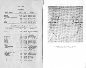

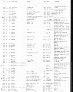

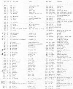

if the vessel your looking for has no contract then use the next best thing and find a vessel of the same time period and size. Most ships of the same size and class were built the same. I do have quite a few contracts in my personal archives.
contents of ADM/168 and ADM/170
Shipscontract's001.jpgShipscontract's002.jpgShipscontract's003.jpgShipscontract's004.jpgShipscontract's005.jpg

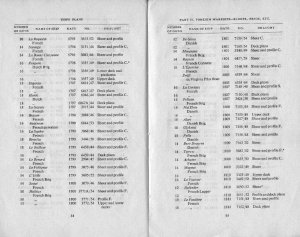

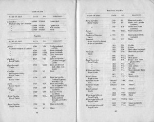

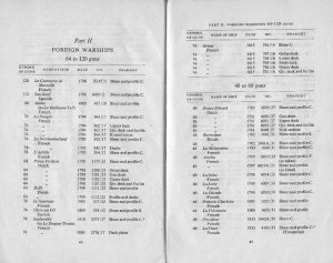

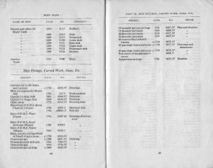

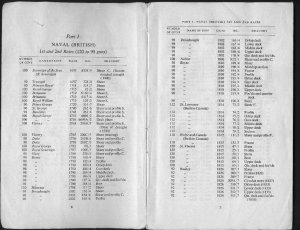

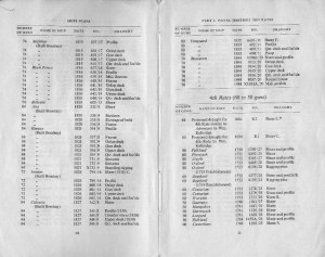

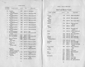

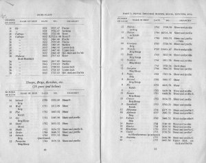

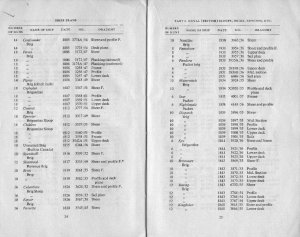

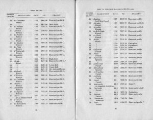

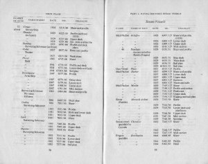

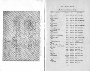

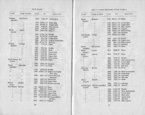

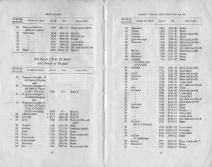

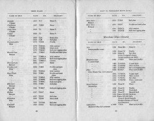

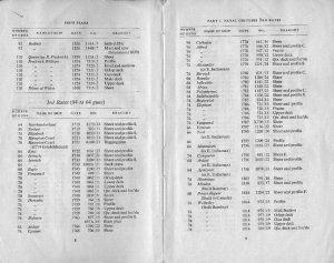

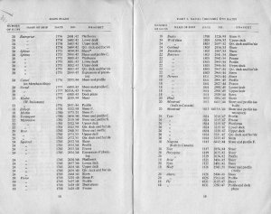

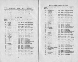

David Lyons was the British version of Americas Howard Chapelle here is David's original listing of ship plans in the NMM
when I order plans I will order a photograph of the plans rather than a photo copy. some of these plans can be very large and very expensive. a photograph or high resolution scan is much cheaper and can be traced in a drawing program.
NMM00.jpgNMM01.jpgNMM02.jpgNMM03.jpgNMM04.jpgNMM05.jpgNMM06.jpgNMM07.jpgNMM08.jpgNMM09.jpgNMM10.jpgNMM11.jpgNMM12.jpgNMM13.jpgNMM14.jpgNMM15.jpgNMM16.jpgNMM18.jpgNMM19.jpgNMM20.jpgNMM21.jpgNMM22.jpgNMM23.jpgNMM24.jpgNMM25.jpg

I have plans on order for Brig Sloop Speedy, which is sister to Flirt. Only Flirt is in above index but I assume they are the exact same plan and the indexer missed that but the online NMM caught it. I do have the contract for a similar sized brig sloop, but Speedy and a Flirt are a unique design so I hope their contract exists. Above material is a fantastic reference. I am seeing references in ADM 180, especially to flirt, but description is inadequate to get me to purchase copies. 1.28/2019. Got deck plans, but instead of the side profile for Speedy they sent HMS Surprise!
