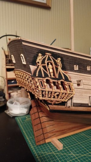

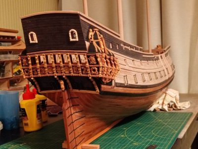

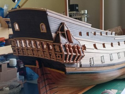

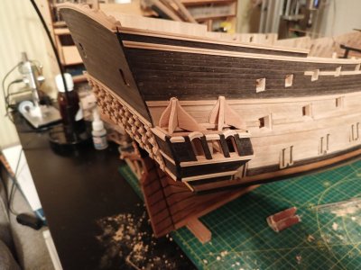

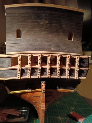

Great to see this latest update Karen - thank you for sharing such excellent work. How are you planning to finish the wood carvings out of curiosity?

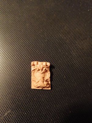

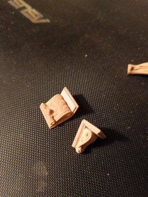

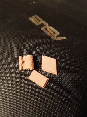

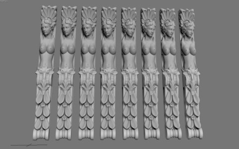

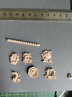

I didn't understand the question. I draw the decor, then prepare wooden slabs of the required thickness, and then cut them out on a machine.

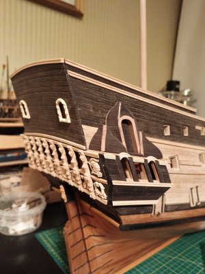

At the same time I cut out the decoration for the stern

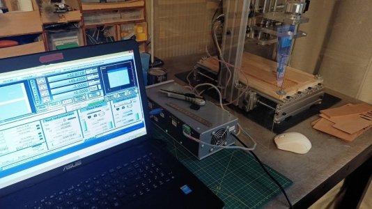

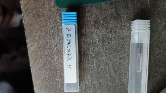

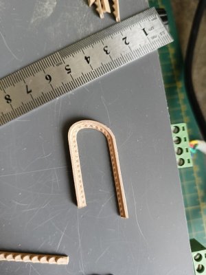

Can you explain more about the process on the CNC system? Do you use multiple shape and size burrs or something else? If multiple tools, does the CNC get programmed to change tools automatically? This is probably way beyond anything I will take the time to learn, but maybe.
Thanks
I only use one cutter. I don't change cutters; my machine is simple and can't change cutters. I drew the model, created a path for one cutter, and cut out the part.
