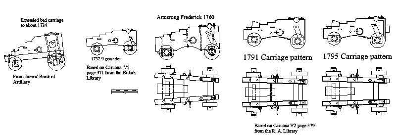

On the lower deck, I decided to make the gun carriages without wheels. They will need to be glued well so that they do not accidentally come off. When I glue the deck with slats, it will be impossible to get to these guns.
I realize it is far too late now, but for the future, English carriages at the time of Resolution and up to about 1724 were extended bed type where the brackets sat on top of the extended bed. After that period there was no bed.
I made these gun carriages conditional. It is important for me that they are well glued to the deck. I will make the guns on the upper decks as in your picture.
Some like to add brass pins to the trucks (wheels) and into the deck with some epoxy to make sure they are secure. No mattter, if the upper deck is closed in whatever you do on the lower decks will not be seen. :)

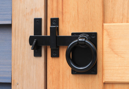

I have a question, what kind of door handles were on ships in the 1660-1670s?
Hi Karen,
The only picture I could find in The Master Shipwright's Secrets by Richard Endor were ring handles on his painting of Tyger. These would likely have been incorporated with a Suffolk latch if from the 17th century.
Only the gun barrels will be made of metal, and the gun carriages will be made of wood. Just not like the ones on the model. These are later. Mine are slightly different.
