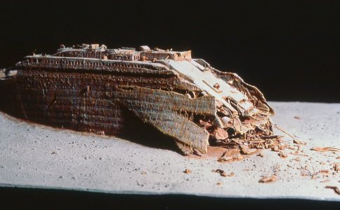

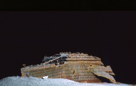

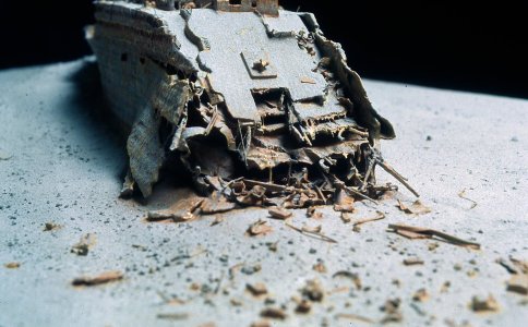

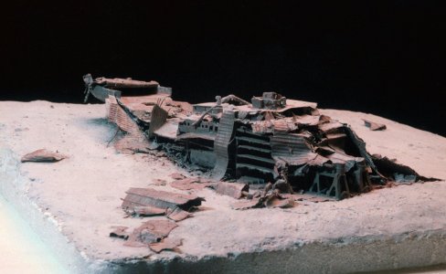

If you're still out there, I hope you got further on your project. I did what you're doing, but I did it using only Ken Marschall's paintings because there was no video footage (and no internet!) in 1989.

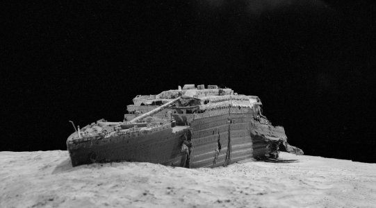

I wrote an article back then, which led to working on a project with Ken in 1990, using the Minicraft 1/350 kit. (the article in pdf format is too large to attach here. These pics are of the 1/350 scale. A lot has changed at the wreck site in the last 39 years, would love to do a wreck model using the Trumpeter 1/200, using recent wreck images, but time and finances prevent that.

Back in '88, I was just focused on "recreating" Ken's paintings. It was like doing a painting of someone while working from a live model. If I saw a section that needed thinner hull plates, I just scraped down that section. The rest would be hidden inside the model where thickness didn't matter. For thinner, twisted metal on the aft end, I just used aluminum foil or super-glue coated toilet paper. There was not enough data from the dives back then to do an accurate detailed representation, and at 1/570 scale, I just needed to get the illusion of accuracy.

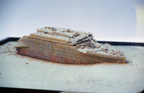

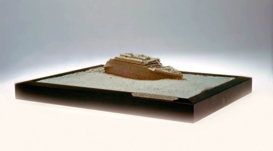

I did some digging and found some pics of the 1/570 version...
