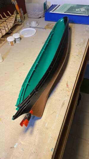

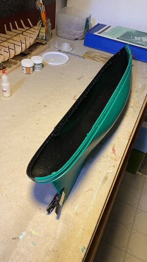

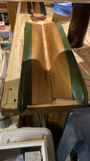

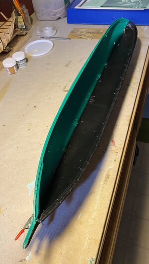

Well, this is turning into a build thread for both Revell models. My son Jay is taking on the Cutty Sark, and I’m building the Thermopylae..
Fun time painting the hull and the deck tonight.
Apparently Testors no longer produces Model Master Enamel paints anymore.

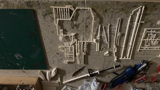

The Thermopylae is missing the sails from the kit. We aren’t sure yet regarding the rest of the parts. Both kits were listed as “used” on eBay.

I bought this also off ebay. It had been started. I have also found the masts to be warped and broken.
I will attempt to repair them, but I don't know how I am going to correct the warp. Who ever had it before tried heat and it just made the problem worse
I also have Revell . U.S.S. Constitution which I am working on.
Waiting under my bed are U.S.S Kearsarge; C.S.S. Alabama; U.S.S. United States; Clipper ship Thermopylae.
I think the Cutty Sark is going to be my biggest problem due to the warped and broken masts.
If anyone has a technique for repairing these please tell me.
Thank you
Everything aloft (masts and spars) would best be made from scratch. Use the kit ones to copy. Saves time and would be superior. Mast caps and platforms could still be used.
I was thinking about the problem last night and came to exactly the same conclusion as Pugwash above.
Would be worth looking at some of the hard plastic tube you can get off model suppliers, and even cut off the mast tops in the kit and dowel them onto the tube to save the detail. Failing that, scratch build with timber dowel.

I always hit my coppered hulls with a very thin wash of diluted black. Cheap and easy. If I used too much it was a quick rub with an old handkerchief to clean up. You are making me think I should drop Netflix and build one of the dozens of plastic boats growing dusty in the basement.

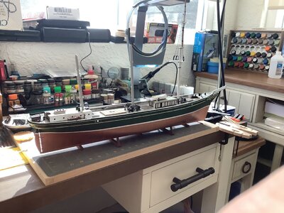

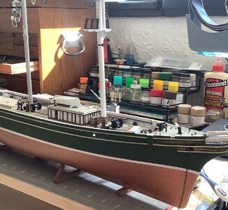

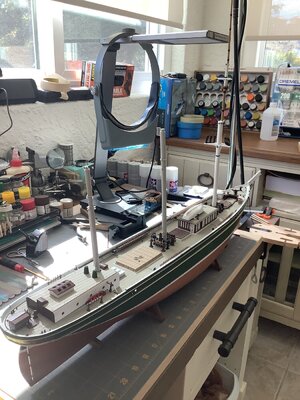

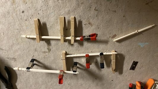

I am also building the Thermopylae. I think I built the Cutty Sark 3 times through college in the 60s. A couple of years ago I bought both Thermopylae and Cutty Sark on eBay before prices skyrocketed. I ended up using both kits to build one ship. Some of the parts, especially masts, we’re warped. The Cutty Sark masts weren’t any better and had parts only partially formed. I checked on line for a fix after my own attempts were dismal. I worked up a procedure that works reasonably well. Fill a pan with the hottest water you can get out of your faucet. Place the part in the water and leave for about one minute. This softens the plastic enough to bend it with your fingers. I tried it on a spruce runner and could bend it double without breaking. I used a cutting mat printed lines to get the part as close to straight as possible. Once you’re satisfied it is straight enough Leave it on the mat and clamp it in position until the plastic cools ( several hours). If you don’t clamp it the piece will return to its original shape. I found I had to do this several times before I was satisfied. It not perfect, but close enough to finish straightening it out with shrouds and stays when you rig it.
