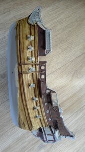

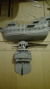

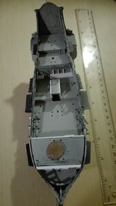

Here hull and transom side by side.

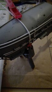

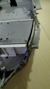

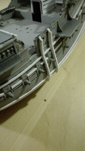

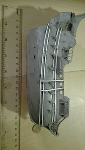

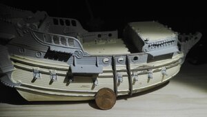

WALES AND FENDERS

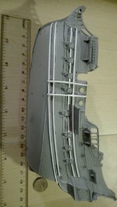

The wales and fenders were added from Evergreen square bars.
Her a little "walk around"

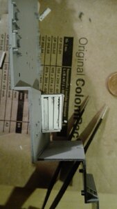

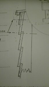

BREAKHEAD BULKHEAD
The breakhead bulkhead was build in the matter I found on
old Eastprussian "journey barges".
And was able to figure out a cut through
in a drawing of Werner Jäger in his monography: DER REISEKAHN MARIA
Where you can see that the cut offs were used on the "night houses" sides as walls.

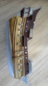

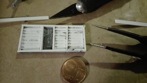

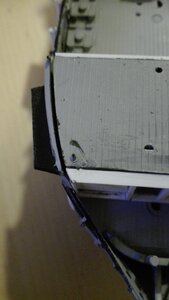

Here my start on the stairways sides.
My"interpretation" of th clinker wood structure.

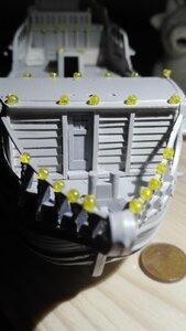

After adding primer I was quite satisfied with the result I had got and added a baroque surplus.
It looks fine but doesn't
fit to the kits shape
so I had two Great Canyons side by side.

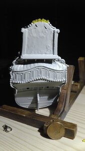

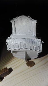

THE TRANSOM

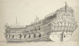

A very sophisticated pice of Dutch baroque ship's decor is the elaborated transom:
Here by William van de Velde
here by Revell...
This is the last primed picture.

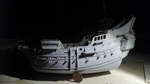

This is the recent status of my project:
The Transom is readyfor the cloudy sky in the background and the "shelf" for the cow is in place. The gunports will be opend later on.
I voted for very light colour as my basis to imitate the wooden look. As I try to get some warm nice looking as clase as possible to the "real wood" as I am used
to work with inks to get the pladzic to look a bit more like wood. A basic colour in some kind of brown very fast starts to turn into a "mocca brown" you are not able to find distinguished details for you eye to catch.
So I try to vgive the viewer's eye details to rest on - as on the transom's inside I will add a typical baroque painting in this circle.
This is the hull as it appeared before "inking" in a "Iraghy light sand" by Vellayo.

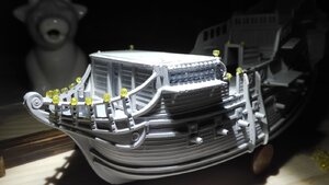

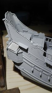

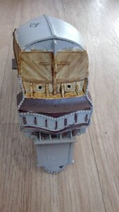

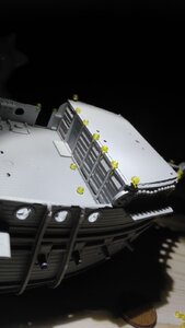

Here my pearl's additives...

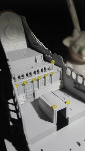

On the deck's staircase
the inner bulkhead in clinker optic.
These pearls are from a girl's necklage kit.
And from a cheap necklage I was able to bring a carvings to the side gallerys.
So I am able reboot this project - this is only the start of the decoration. There will be some more detailling in the next weeks.
