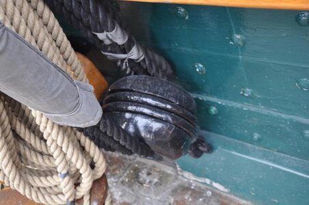

Here you can see what Bentinck shrouds are and how they are fasten on the ship
the problem seems the hole and your drill which is to short. You need a 6" span to drill.
Maybe you can use a welding wire where you can sharpen the end round and flat. And then with a lot of patience drill a hole.

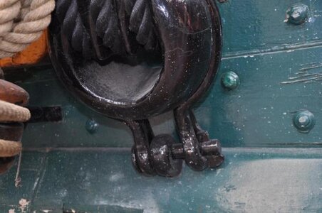

I think you mean this hole in the deck for the eye bolt
View attachment 231190View attachment 231191
That is my problem shone in in real life. You obviously have toured the Constitution! I must drill from one side of the ship to the other. Masts and shrouds (sans ratlines) are all up and fore and mizzen stays have been place. Missed my chance when I was outfitting the deck. The confection is on the waterway and certainly pierces the deck below. I think this attachment point is out of the question and I will have to anchor into the planksheer. Very tight. I will try to add an extension piece to my din drill.

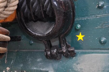

What if you drill through the side board, place on the outside a rivit or camouflage it behind the paint, nobody will notice
see example place yellow star
I have considered this and it may be the easist solution. Probably will be a "hit and Miss" attempt and could involve seveal punctures, but those that are not correct can easily be concealed with a drop or two of paint. Thanks
