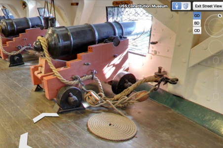

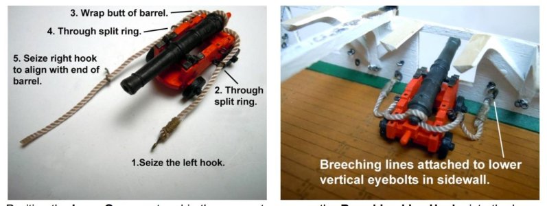

The Model Shipways kit of the USS Constitution cross-section has the breech lines terminated in hooks that attach to a single vertical ring on each side..
Yet the present day ship has the breech lines ending with spliced thimbles that appear to be bolted between two horizonal rings.
I'm going to go with what's actually on the ship, which is supposed to represent the 1812 era.
A hook in battle doesn't seem secure enough to prevent a gun from blasting its own ship if a hook was knocked loose by enemy action just as the cannon fired.
