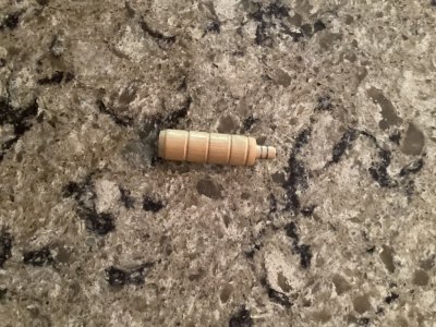

I suggest that you make the little tool in the photo. In my case the two black bands are increments of 1/8in but of course mm would work fine too. Wrap your line around the smaller cylinder, count the number of turns to the mark, and divide the distance to the mark by the number of turns.
Quick and easy!
