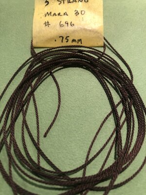

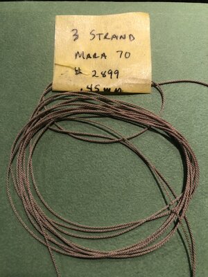

I just did my own experimenting and when I found a formula I liked, I wrote it down for future reference. I have 3-4 "go to" sizes for my current build.

There are a lot of variables… I’m happy to share but I use a specific thread for my ropes and other types, sizes and brands will lead to different results.
If you still think my info would be useful to you, let me know and I’ll post my common sizes formula for my current build (1:48).
1. If you are making a three strand rope (right or left hand twist) each strand will have a diameter one-half the diameter of the finished rope. In your case, a three strand rope of diameter ".8" will have three strands of diameter ".4" each. Note - when you describe your work, you need to include the dimensions you are using i.e. inches, feet, centimeters, millimeters, etc.
