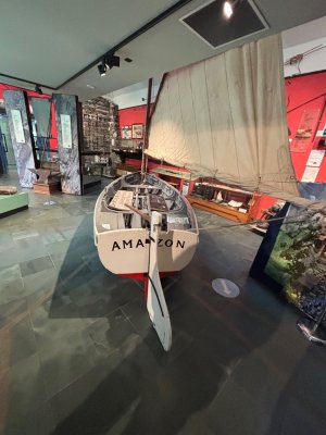

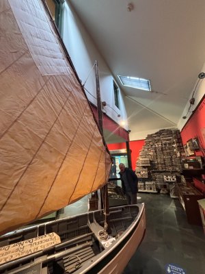

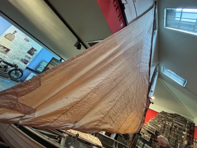

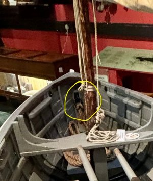

I see that you have added bottom boards , Swallow must have had these over the ballast in the bottom of the boat, what did make these of?

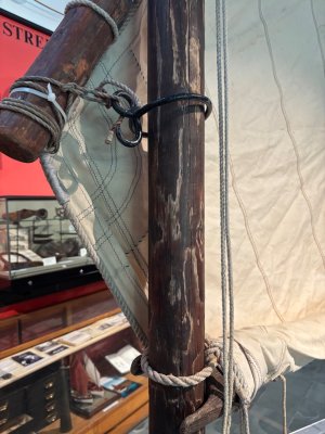

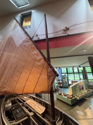

Just seen your pictures, that's just what I needed. The cleat on the mast would be the the best as easy to make off and undo. The main sheet goes to transom, often these are attached to a rope across with a pulley for the sheet to go through and just held with your hand on the tiller

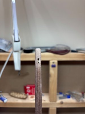

mine will static, I would be interested how easy it is to put a pulley into the top of the mast for the main halyard
