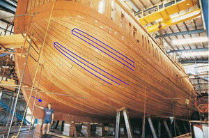

I have just started the second planking, I am planning to change the dropplanks sequence. In the first planking the first dropplank (direction towards the keel) is longer than the second dropplank. I believe this is wrong, so in the 2nd planking am making the 1st dropplank shorter and am making longer the lower one.
I do not think is is directly wrong. Good quality wood in the times of wooden ship building was a scares and expensive good, so they wood get most out of it. This means the stealers and dropplanks were fitted as directed by the wood used.
See below some pictures of the use of dropplanks and this is not showing the lower one should be shorter, but it is directed by the shape of the hull, the flow of the planks and the wood used.
@Maarten Thank you very much! Nice of you to give this guidance.It makes sense what you just explained. I was wondering about the planking/dropplanks of some ships. For example now I realised that the greeks use the same method as the the hollaendische schiffbau. Still I have to tell you that at the end I did not corrected the above mentioned drop planks. Although I was planning to, my engineer's sense told me it looked engineer wiese better ... so I let it be.
