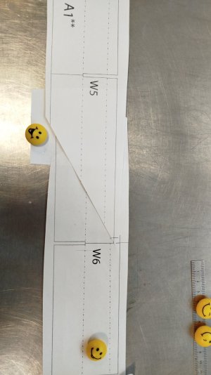

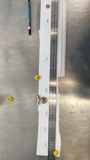

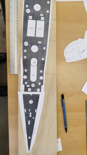

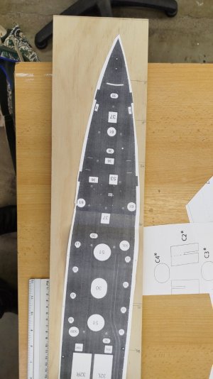

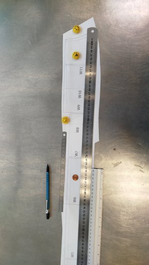

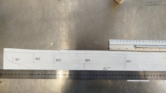

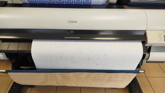

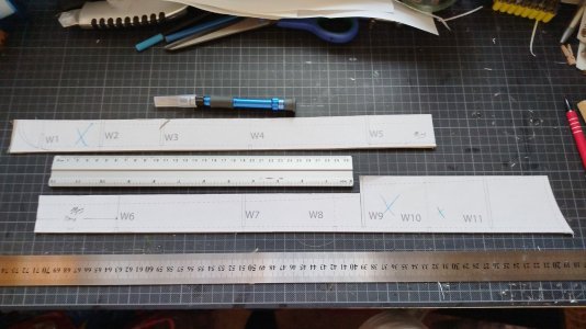

I decided to enlarged the drawings by 312% to get my 1/64 parts in one piece, the errors are piling Up to inaceptable numbers! :-/
Back from the Copy Shop and invested into ink drawings:

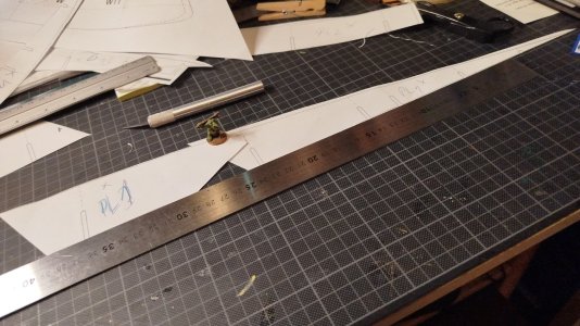

so the lines do stay straight (as a laser xerox does warm the paper and it is wrapping in all directions when cooling) and I cut the DIN A0 sheet into manageable sections on an "under light table" with a wheel cutter:
So now we can restart the boat of the safe side...
So up she goes - and I can trust into this drawings enlarged by 312% from 1:200 into 1/64 scale.

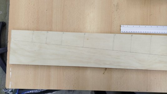

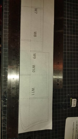

Today I figured out my work bench is on it's length's limitation! So here we are with the centerboard
39"/990mm at all - I have to take away a storage box.
Hello friends, today was a day of a good progress: dealing with the centerboard from 2mms book binder card board was the job. I did use spray canned glue with a good result. I decided to cut it in half for easier handling What you do see is my hole work bench in the very background a cactus terrarium.

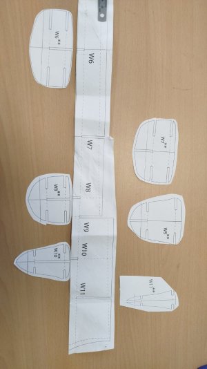

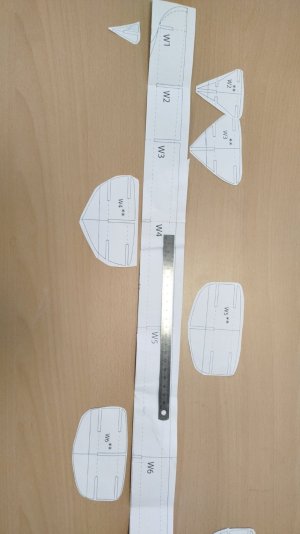

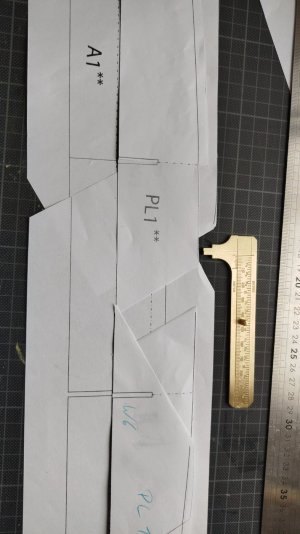

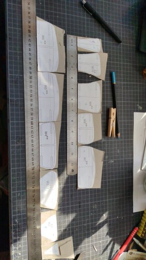

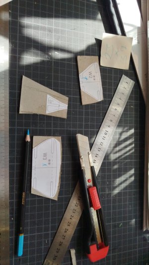

No big progress I just cut out the bulkheads
and am awaiting my purchase of the 1mm bookbinder cardboard so I can clad them onto the 2mm I do have - so the slots in the drawings can be used as they are...
Hello friends,

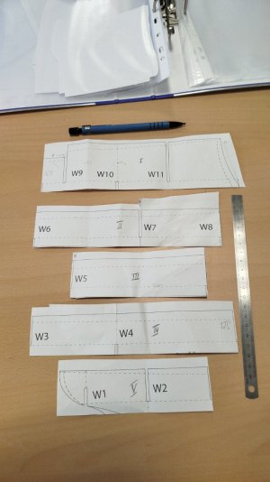

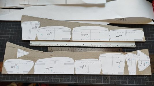

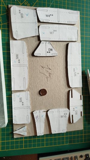

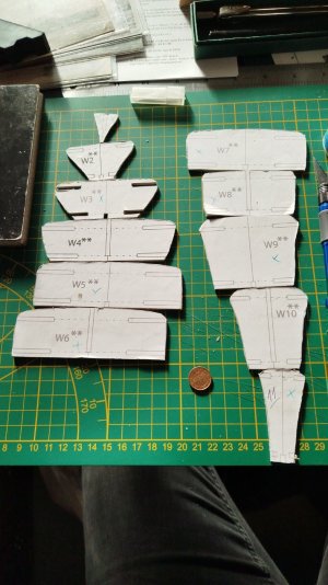

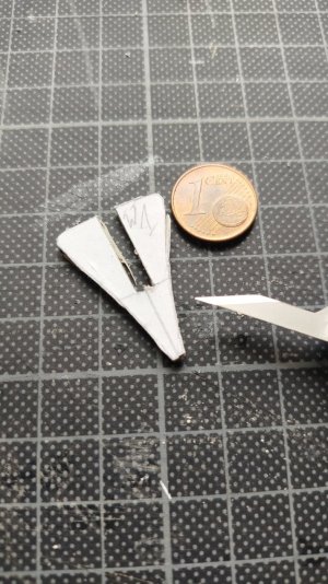

today a little bit of progress to the bulkheads - all outlines cut out:
...and all these glued onto one millimeter cardboard:
All the slots will be cut with a chisel in the next step.
