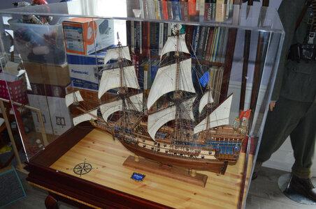

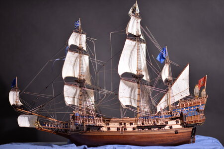

HI. TAKE INTO THE ACCOUNT THAT NOT ALL SAILS ARE GREY. SOME ARE WHITE TOO. HAVE A LOOK A THE ATTACHED IMAGES
