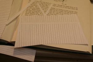

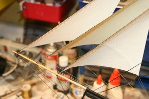

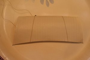

This is an older thread but the question is very valid. Many refuse to add sail because of the sail provided with the kit or the available material is out of scale..resulting in bulky, over stiched sails. Causing the otherwise fine scale model to appear toyish.

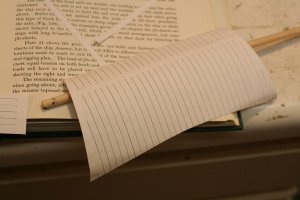

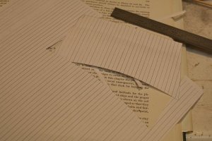

I've experimented over the course of many years the use of paper sails. Simple copier paper.
Fist by drawing on the sail(both sides) the scale panel lines. Then make many copies(both sides) of this master to make your sails from.
Then measure out your sail, remembering to allow the sail to be slightly longer from head to foot to allow for the billow you are going to form into the sail.
Here are some images of my process.
IMG_8145_JPG_9b89e12af75ebb8fe63259939b2710aa.jpgIMG_8146_JPG_7451864f89ebb36720159ee7b10f6112.jpgIMG_8148_JPG_80e9b6415fa9e71dad300b7c7474f5f9.jpg

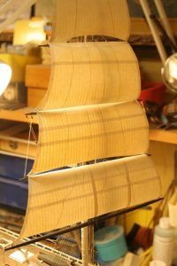

Jun 19, 2013
329
158
You then must add the clews and any points of contact prior to painting the sail.
Once painted the shade you are wanting..then rig the sail with the buntlines.
Jun 19, 2013
329
158

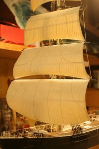

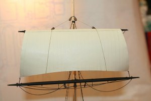

Jumping ahead....you then bend the sail to the yard. I simply glued the sail using good wood glue.
Once the sail is set....support it with a cotton tip applicator from below pushing the sail outward so the sail head will be more at the proper angle from the yard..then straight down. This aids the sail in retaining that billowed effect.
At this point you can run your sheets and add buntline blocks to the buntlines.

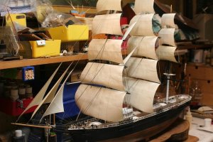

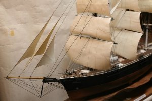

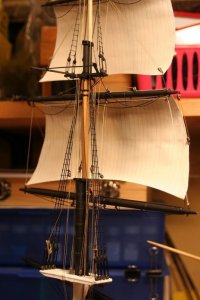

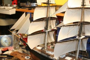

Jun 19, 2013
329
158

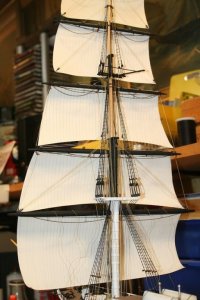

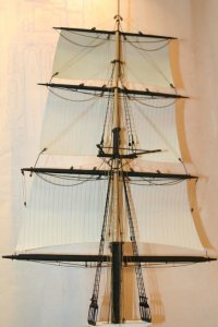

Moving further ahead, as you progress down the yard adding the larger sails..the same process is used to make and attach these sails....remembering all the control lines needed for each particular sail.(This is an altogether different subject).
IMG_8176_thumb_JPG_1416ebcd87a8291af88df78067545fa0.jpgIMG_8190_thumb_JPG_c92b6a9d368cc2c921b8b2db039f84f1.jpgIMG_8342_thumb_JPG_917c38805581b7d627a7492371fb5a92.jpg
Jun 19, 2013
329
158
In my view...sails are the main attraction on sailing ships, and unless you are modeling your model as it would appear in port in lay-up, where the sails are completely removed...sails are just as much an important part of your model as is the cannon...the ships wheel, or the masts.
Paper is an inexpensive and easy medium to use and once painted it becomes rigid enough to easily hold its own form.
Once cut and the sail has its bands glued on and it is rigged with its hardware and painted.not much more then an hour has passed. they are quite easy and take very little time to make. Reef points are added after the sail is bent to the yard.
Stay and jib sails are done differently, only that you need to add the hanks as part of the sail hardware before fixing the sail to the stay.
Jun 19, 2013
329
158
To add or not to add sails should be based solely upon the setting you want your model to be depicting. In lay-up/dry dock...no sails. In port awaiting cargo...furled, and when at see...with sails set and this in of itself lends to many configurations dependent on the weather.
