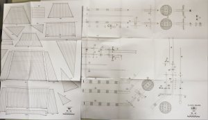

I am looking for the rigging plan (and sail rigging) of the Saint Philippe
I know that Ancre has a full monography for this ship but I am just looking for the rigging plans.
Can anyone assist?
Thanks
Hallo Gilbert,
when I checked the Saint Philippe monograph I can state, that there is not so much information given for the rigging
The drawings which are related to
masts and spars
Pl.41 Mainmast spars
Pl.42 Foremast spars
Pl.43 Mizzenmast and bowsprit spars
related to sails
Pl.44 Sails (1/96 scale)
and some small information on the standing and running rigging
Pl.45 The St-Philippe under sail (1/96 scale)
but that is all

Hallo Uwe
Many thanks for your reply
Very useful indeed.
I could imagine that the rigging information of the Ambitieux could help you more
