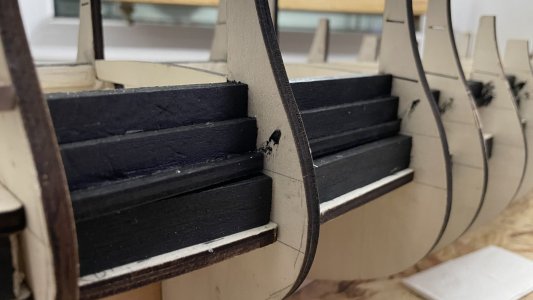

I started already 2 month ago with fitting everything together. Last week the first gluing and coloring the balsa strips black.

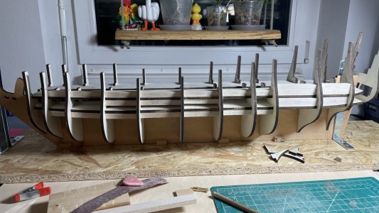

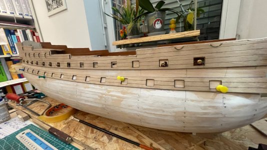

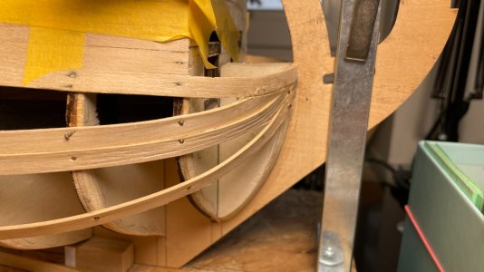

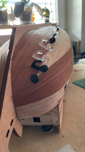

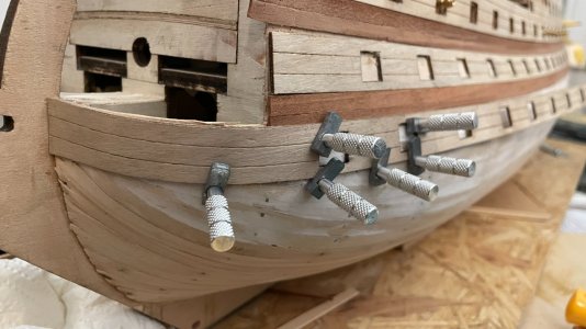

Took a while to continue on the St. Felipe due to vacation :-).

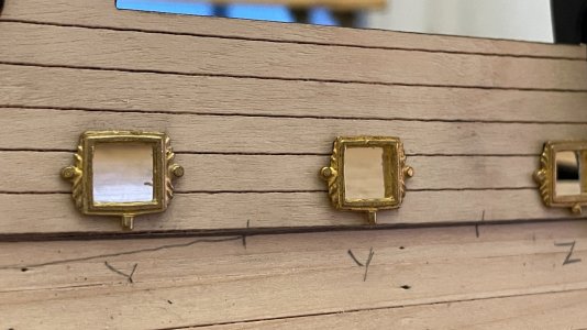

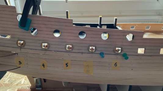

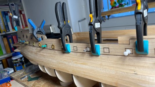

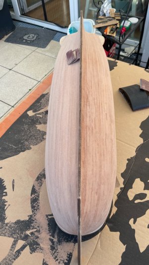

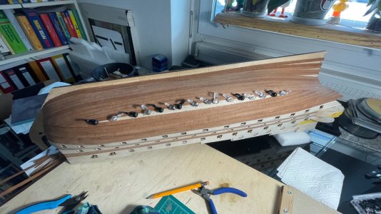

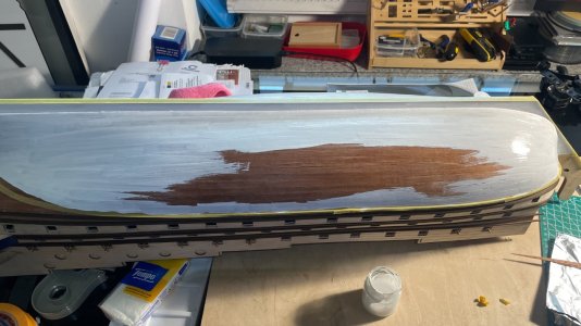

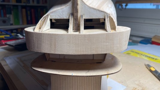

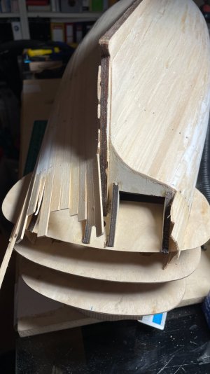

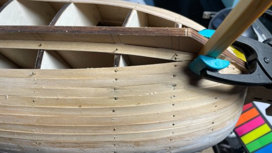

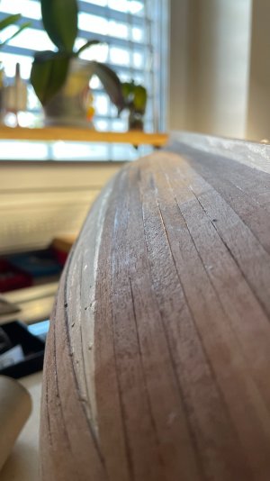

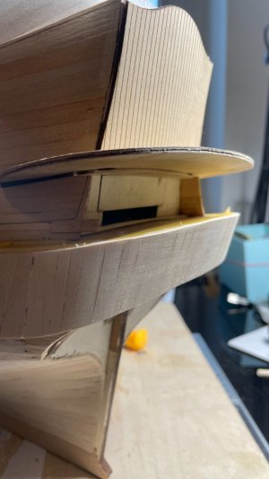

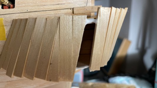

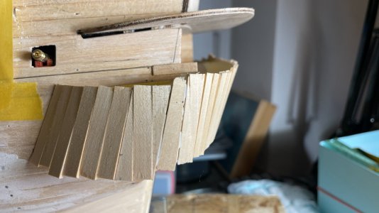

After gluing and coloring the balsa strips I glued in the first false deck. No problems with that. Had to adjust a little bit the fitting but nothing serious. Afterwards I started to glue the first planking of the hull. Started with the "main plank". This one I glued a little bit higher than indicated by the plan. Maybe I need some more extra space for the cannons.

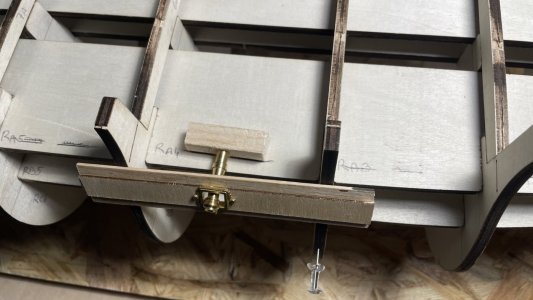

As some of the top bulkheads will be removed and to avoid that the planks would be glued to them I put some tape on the top of the bulkheads so that it is easier to remove them.
So nothing special yet. Going step by step. Pictures below.
Cheers Chris

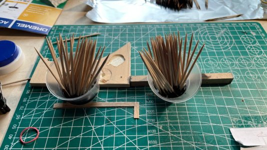

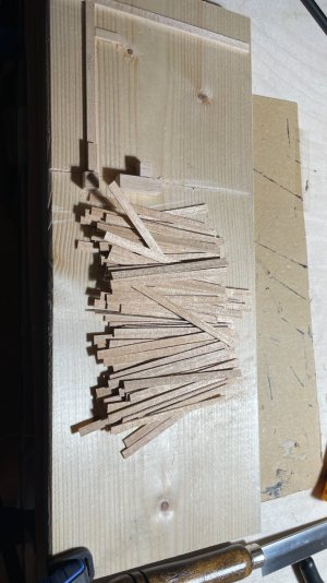

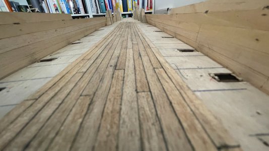

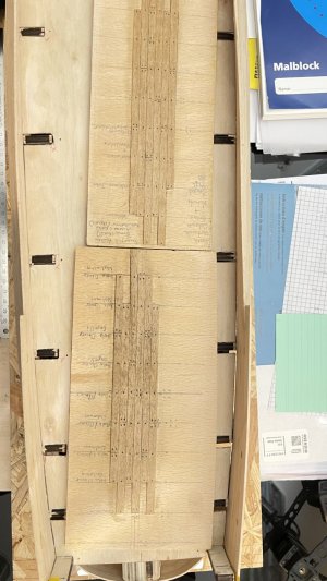

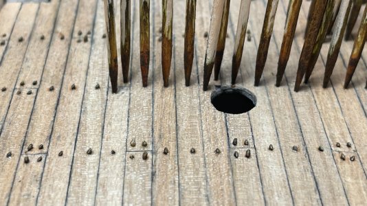

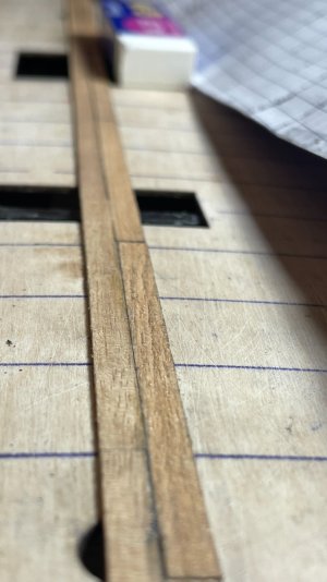

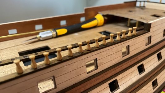

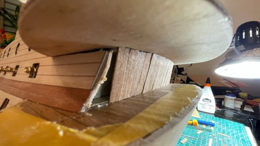

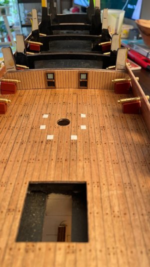

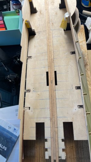

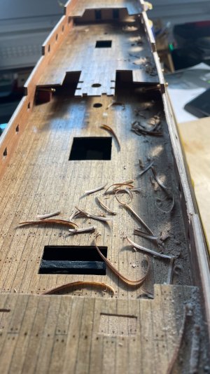

A little update from my side. After planking half of the hull I decided to follow up on the decks. The included deck looks not really satisifying to me and I would not be happy with the look of the deck. Therefore, I investigated how to do the planking of the deck on my own. I decided to use Tanganjica strips. Ordering take some time and now I got them 2 weeks ago.
First step was to do some testing of the planking on some spare plywood. The goal was to get a feeling of the length of the planks and how it would look with different coloring. Furthermore, I also tried out tree nailing.
Both versions you can see in the picture below.

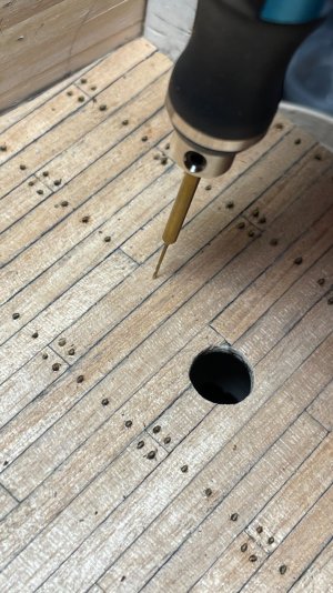

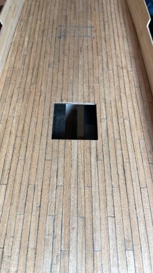

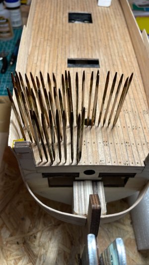

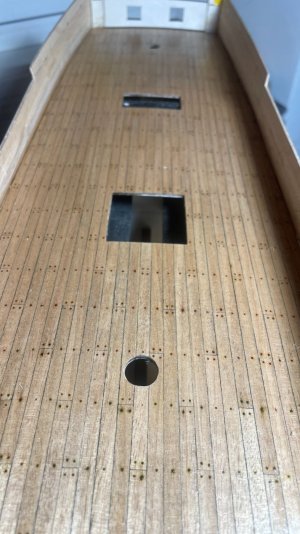

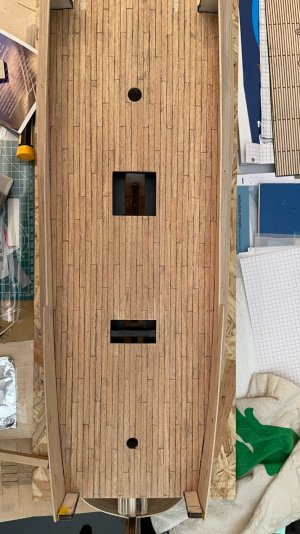

It have been a long time since my last entry. The last couple of weeks I was busy to plank my main deck. I underestimated the time it consumes but now I have planked my first deck and can get rid of the laser cut deck. I also used stained toothpicks as treenails. Here I am a little disappointed because the stain bleeded out once I varnished the deck. Lets see how I can compensate that in the next decks.
Some pictures from my journey of deck planking.
Cheers Christian

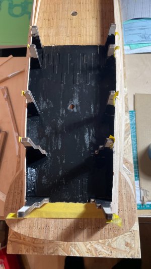

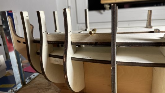

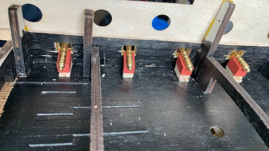

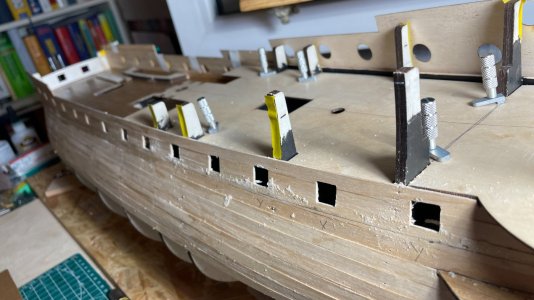

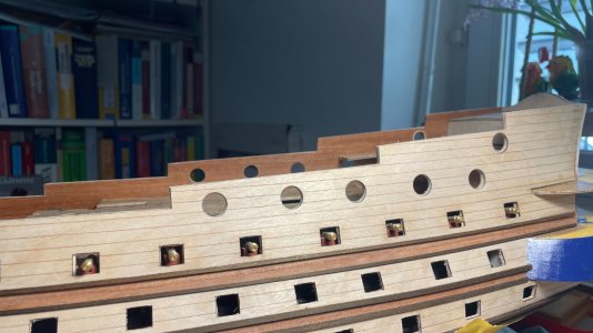

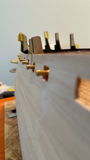

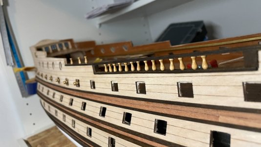

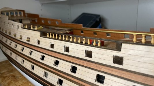

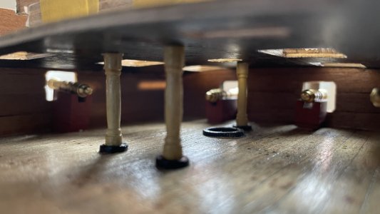

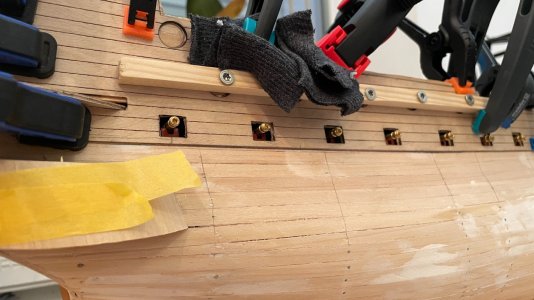

Another step done. I decided, before going on with the upper deck, to install already the cannons. I foresee here a lot of trouble when placing them after the deck has been installed.
First step was to open the gun ports. (Hopefully at the end everything will fit :-) ). Next step was to paint everything black, assembled the cannons and fitted them to the gun ports.
No bigger issues here. I had to adjust the height of the guns to fit to the gun ports.
Now it is time to fit in the deck and glue it in.
