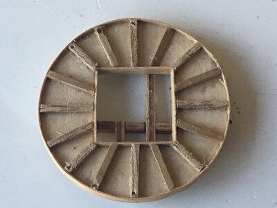

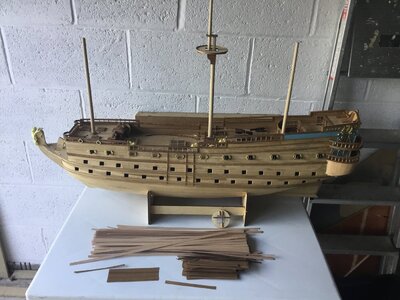

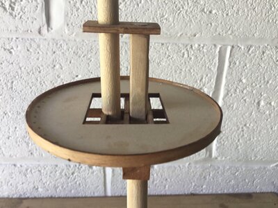

I have just done some sorting out of the parts that I have and taken stock of what to do first, don’t think there is anything or much missing, indeed I think I have more materials than will be used.
I have taken some photos to show the current situation regarding present build stage, broken bits and some that I’m not sure on.
The masts are on and glued in so will have to be careful handling when I tackle cutting out the gun ports on the other side.
The strip material has me puzzled, the long lengths are 0,55mm x 7,0mm and the short darker ones are 0,4mm x 4,3mm.
The round ’thingy’, go on tell me what it’s really called, has been broken off thE boom? during transit and needs 2-New Cross members making.

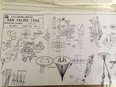

Is it made correctly or should the top be planked.? The plan page 8 says ‘White strip mm0,5x 3.

Looking really not so bad - better to say it visiversa - looking good

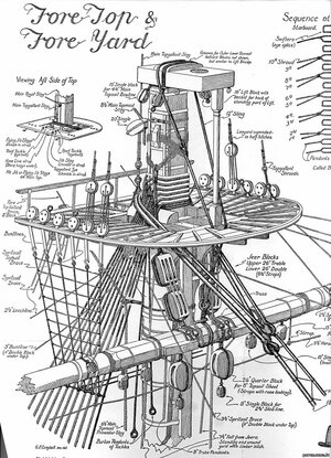

The "top" is usually made out of a grid structure on which boards are fixed
Typical sketch
Maybe it would be good to start a building log, starting with the actual status. Here you can show more in detail the status of the model and also the future progress , you can ask questions and the members are able to comment or give hints and tipps

thank you so much for confirming that they should be planked as I thought.
I think the broken one in my photo needs a strip down and start again just salvaging the plain disc.
To finish the one mounted on the mast will need some surgery to get off and some juggling to assemble back onto the existing mast joint.

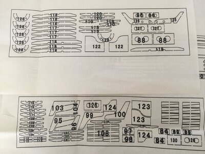

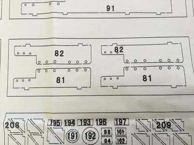

This is looking like a problematic task as I suspect the part numbering is ’up the creek’.
I have tried to identify the notched cross members that are underneath each of the round discs from the assembly drawings and the set of what I will call part pattern drawings ( they are on a different type of paper), initial look makes me think numbers don’t match on some.
Will have another look this morning and post photos to explain if I still think they are incorrect.

Anyway after more pondering and part identification by a process of elimination and scaling I have I think sorted out the few parts that were puzzling me.
I have attached photos to illustrate my cause of confusion.

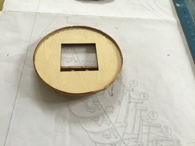

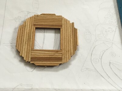

I have made some progress this morning by planking one of the two large discs which join the mast sections, and carefully removed the one glued onto the mast on the ship without damage.
I intend to remove the ‘rim’ then plank and make a new one.
I figure out that the top outer edge should be radiussed in order that the rigging which passes over this edge would not wear due to a sharp corner.
Not sure if the rectangular hole should be ‘lined out’ to be above the planking, at the moment the aperture is planked around flush with the rest, photo included.

PS looking for crosstree part 68 on the shapes that seem to match are in the 100’s whilst part 68 is found elsewhere and looks nothing like a crosstree.
Part 80 and others similar problem.

Hi again all,
Having studied Donnie’s build as suggested along with others, I have a question.
The trestle trees run forward and aft either side of the mast and the cross trees as the name suggests go across and both are notched out to locate together.
It seems that in all photos that I have seen there is a height difference between the top faces
of both, so that the planking or solid disc in the case of the kit, does not sit on the top face of the trestle trees making the outer lengths after the notching not doing any supporting ?
Is this correct, or on the real ship are the notches cut deeper so that the top faces of all cross members are level to support the planking.
