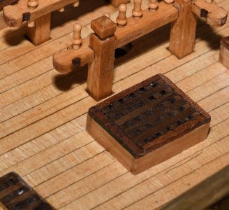

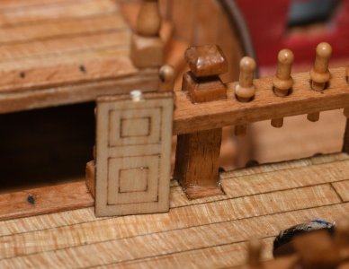

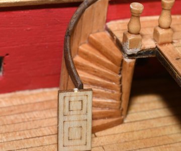

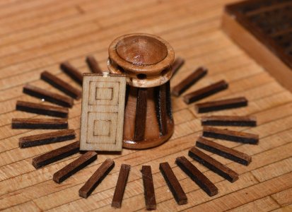

naaaaaaaaa.........was seduced by the pearwood sculptures...kit is weird....would not have done it.......roughing things out yet..1:50 scale?..eg...deck to ceiling is 28mm.......door is 22mm.....you can see the proportions.....even reduced the capstan 3mm......how tall is a man....lifesize maybe 5'6''.....few good things about the kit, but all in all.....nada........06mm planking is a no no for me.....you'd have to buy your own planking....and stanchions..at least in the yuanqing version .....and using different kinds of wood is too much contrast.......like the black walnut gratings...........and should they be so high?........i already bought lighter wood for the deck.
still lots of finishing to do, and i'll go ahead and do my best to make it look acceptable and at least i should get back my money spent, which is too much in this case....i think the caroline would be a much better kit....anyways, no more china stuff....communications too difficult.........oh....also....the wood was so light in color that i had to use polyshades stained pecan.....i don't like stains....always uneven and blotchy....again, i should have bought proper wood.
