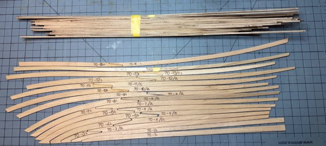

I'm in them middle of a sanding/gluing marathon, removing char and gluing plank halves together. I've finished the Starboard side pieces starting with the first Wale and lower the planks.
The top bundle are the Starboard pieces.

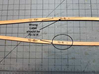

I did find one piece not labeled correctly. Plank #15 "70-15R1" didn't have a corresponding second piece, but plank "70-15L1" had two "70-15 L" on the flat. So things worked out "OK"

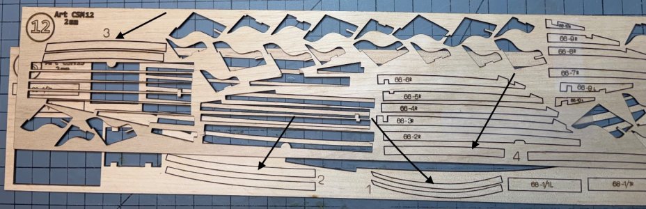

On another note, several builders mentioned missing planking pieces for the upper stern. I used scraps to complete that part and now am embarrassed by finding those pieces on other flats.
Flat #19 has two pieces (71-7/1 and 71-7/2)
Flat 18 has piece (71-14)
Flay #16 has pieces (71-12 and 71-13)
Also on Flats #15, #12 there are pieces labeled with large numbers that I think might be pieces for the waterway for the main deck.
Oh well the finds are to late for me, but maybe the info will help other builders.

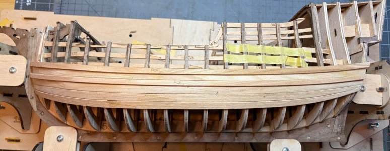

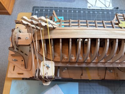

The start of planking , I think I'm going to need more clamps.
Found imagineering is a good standby for trying to hold odd angle bits while the glue sets.

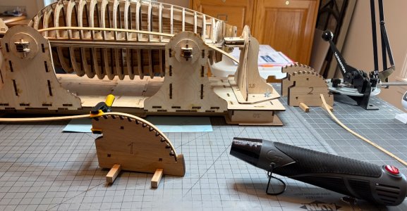

I did purchase Pavel's bending jig kit. Those jigs and a low wattage heatgun make plank bending much easier.
Getting there one plank at a time.

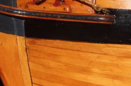

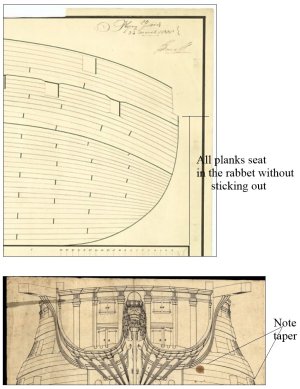

Don't forget to reduce the thickness of the wales at the stem. They were "thinned" as they approached the bow so they could seat in the rabbet. They were reduced in thickness to match the adjacent planking to accomplish this.

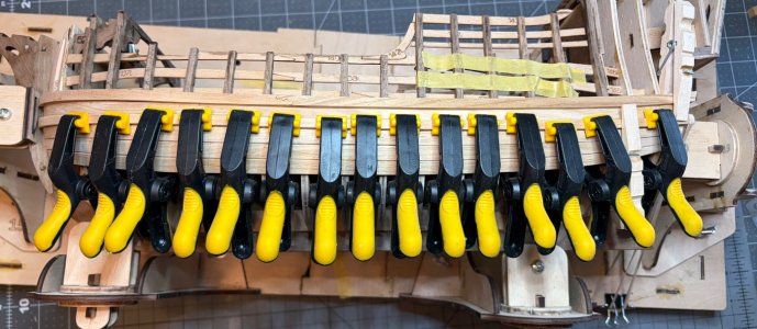

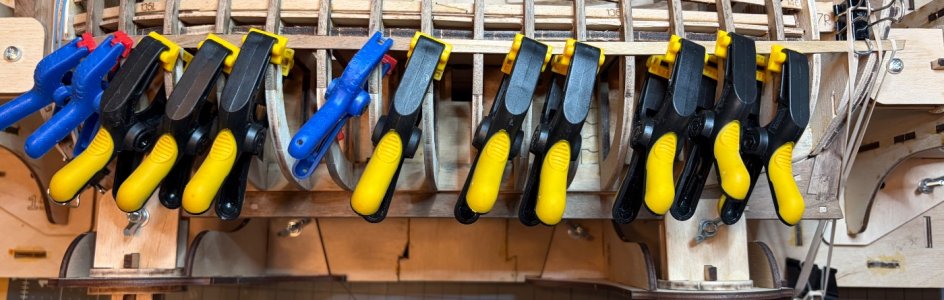

This step adds the bottom Wale while I can still clamp it in place. I can now plank up or down and not worry about the bottom two Wales.
The three inch spring clamps were just right for this part of the project.
Jan

Good morning Jan. You ingenious clamp engineering has resulted in some fine planking. Cheers Grant
Hi Grant, ingenious translates to " OMG how am I gonna do this bit". At this stage of the game my "Brain Power" seems to be fading.
Makes the wood do what you want it to do not what it wants to do. She's already looking like a fine ship Jan; I love the scarf joints.
Yup, the three bending jigs are a tremendous help. That and the passes with the heat gun. I soak the planks ends in hot water (carefully avoinding the glued scarf section), place them in the jigs and use the heat gun to help form them. Depending on the planks final location, it gets formed via jig #1, jig#2 and jig#3.
