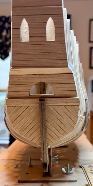

Lower Transom planking Port side:
I started by being a bit more agressive "fairing" this part of the frame.
The next step was to remove the char, lightly sand and glue the planks together as one piece.
Then a few dry fits to get a good fit.
Followed by a final check for a bit of overlap.
With a "filler" piece added the plank assembly was glued in place.
Today is a repeat for the Starboard side.

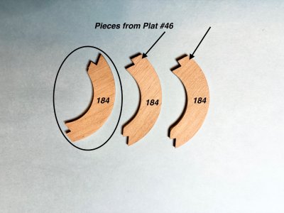

That's great instruction for those who are considering this as a build.

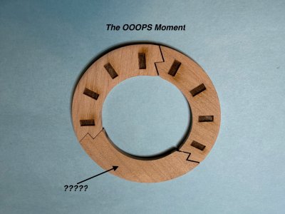

Interesting ... the drawing of the flat shows the parts in the correct orientation - it appears that between there and the laser, one part got flipped over. Does the odd section have the rectangular laser marks on the reverse side?
Yup, that section has the laser marks on the reverse side. It doesn't matter how I try to fit them, one side winds up odd.

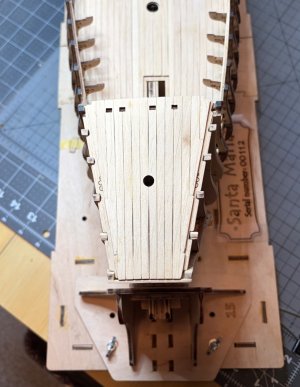

Hmm, since I could not work on the crows nest I moved on to do some deck planking.
Another "Gotcha" moment.

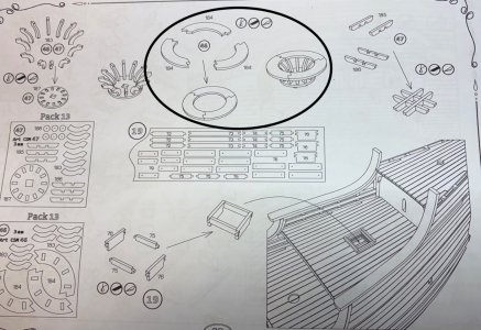

The instruction manual page showing the deck pieces.

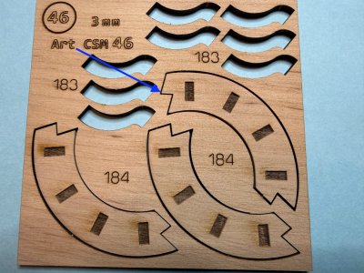

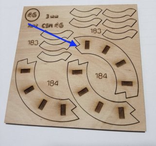

I received this photo from Pavel's shop today.
Flat 46, top of the the Crows nest.
Flat 46 in my kit.
The laser cuts (Blue Arrows) are different.
