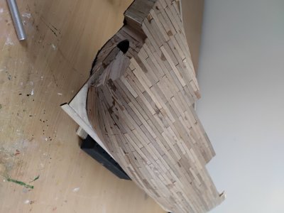

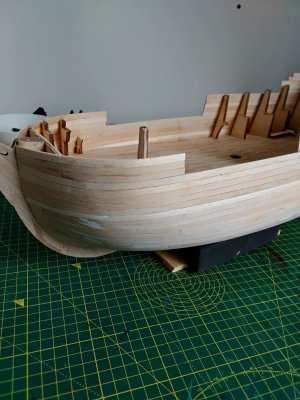

Cracking on with the first planking. This is as far as I will go for now as the base bracket I fitted is pretty solid, so I will now turn it over and work on the decks to get them shaped and sanded -

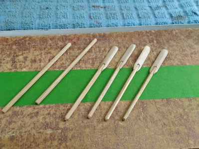

Still a while until Santa comes, so I got myself a plank cutter. I usually use a small chisel, but a hand injury makes this sometimes difficult.
It's an Amati bit of kit but there were a couple of problems with it -
1. The inset base was set too far back with no adjustment available, so cutting short lengths was impossible to get square. I sanded the front edge to pull it forward, scrapped the securing screws underneath and the glued it in place.
2. The handle is somewhat wobbly with too much lateral movement. This was addressed by adding large washers to the pivot bolt.
It cuts square now, but is several degrees off compared to the guide marks moulded on the base.
I am happy with it now and it cuts well, but it could have been a lot better out of the box. Maybe I just got a bad one.

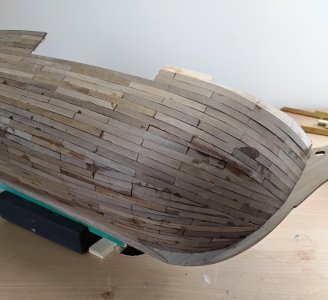

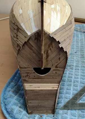

First planking finished, a bit of filler required in odd places -

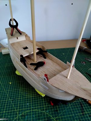

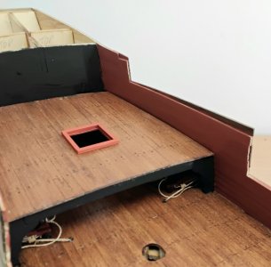

After a bit of fettling a dry fit of the decks and masts. All frame tops now snapped off -

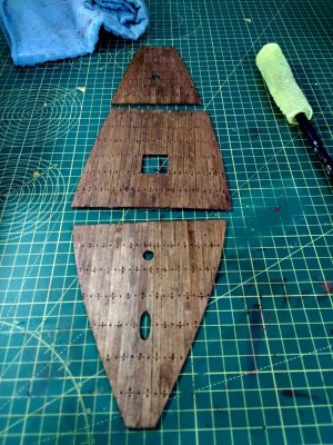

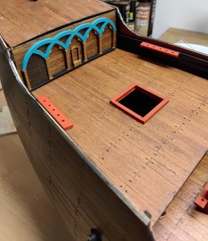

Decks stained -
I used an oil based stain -

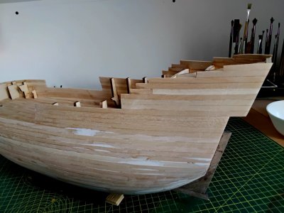

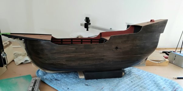

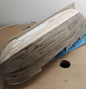

Second planking finished. Given the size of the model and the depth of the hull this has been a bit of a long haul.

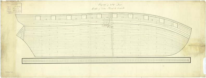

Hi Graham,

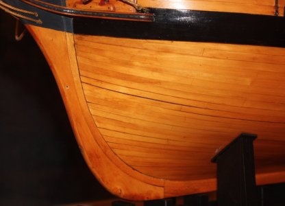

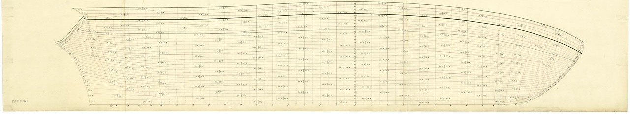

For the future, planking never ended in a point short of the rabbet. Even if a drop strake was needed, it has a stubbed end joggled into the adjacent strake. The planks are tapered in breadth in order to achieve this. Many kit makers use the style you show for some reason even though it is completely wrong and was never done like this on a real ship. Look at any contemporary planking expansion drawing and you will see none of them show planking like your kit instructs. Also check out some photos of contemporary models on the RMG Collections site for helpful information on how the strakes ended at the rabbet.
Examples of planking expansion drawings
Contemporary model showing planking at the bow with a drop strake.

Thank you, I know that perfectly well from other excellent build logs on this site but chose to go my own way. 'For the future' if there is anything else I might do in this log which piques your ire I humbly apologise in advance. Regards.
Hi
No ire on my end and absolutely no apologies needed, it is your build. :) Just thought you might be interested and it might be helpful if you were unaware.

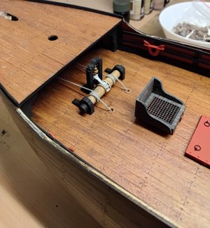

There are only two main cannon on this ship. They can hardly be seen but I rigged them anyway -

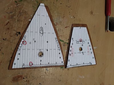

Before I fit the numerous deck cleats I cut out the relevant parts from the drawings to act as templates -
This confirms what I already suspected in that the drawings are not 1:1 and can't be trusted. Illustrative only.

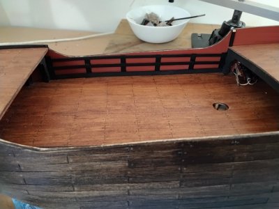

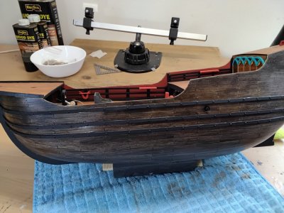

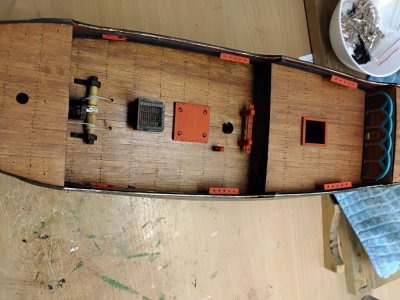

All decks now fixed in place, hull stained dark oak and knocked back a bit with wet & dry -
Work on the interior fittings can now begin -

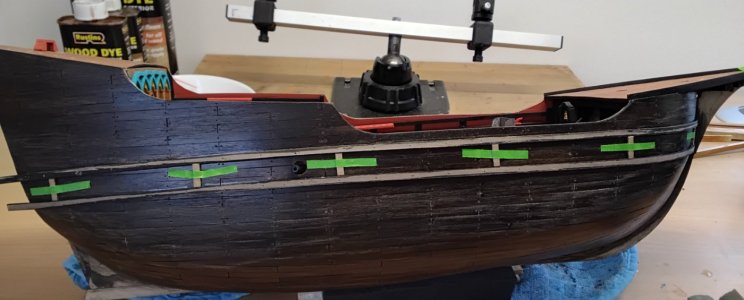

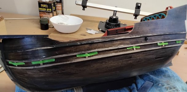

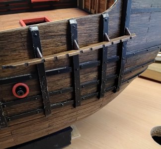

Next step is to fit the wales. No dimensioned drawing, so I eyeballed it based on the picture on the box. Short offcuts used as spacers -
... and the third wale -

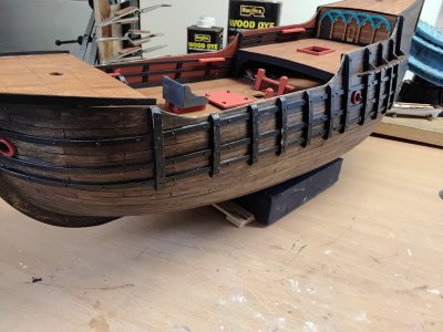

Finished and painted -
I have been unhappy with the hull colour (too dark), so I took the decision and knocked it back with 120 grit and wire wool (below). I lost the paint on the brass wale pins in doing this, but that is an easy touch up.

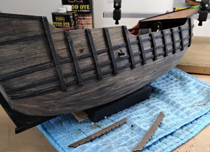

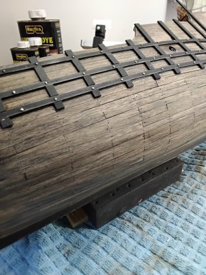

Next are the vertical braces. There are thirteen on the plans, but I thought that was overkill so went with eleven. Interestingly, the current full size reconstructed ship only has three, so the truth is out there somewhere.
First step is to piece between the wales, this being then covered by a second full strip. I pre-painted the full strips, cut ends are coloured in with a black Sharpie -
That's the external bracing done -
Pin heads and cut ends touched up. I have also worn the paint back on the edges and added some dinks and knocks -
Next job will be to flash it over with a couple of thin coats of lacquer.

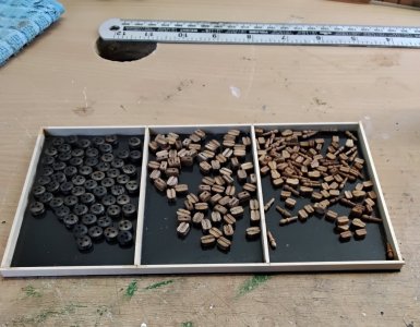

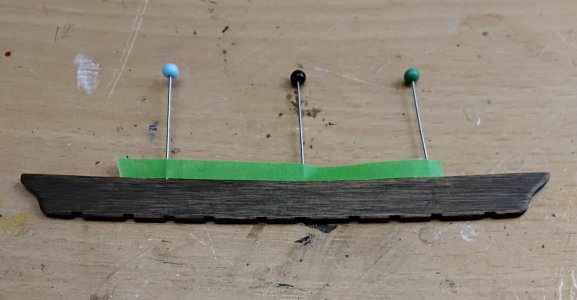

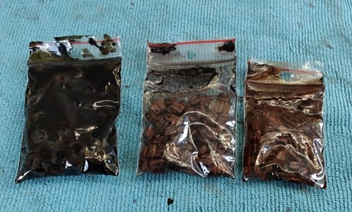

Odd jobs. The blocks are pretty good, but need staining. They come in little grip top bags, so that's handy. L to R - dark oak (deadeyes), walnut and light teak (oil based) -
Washed off with thinners. I even made a container (is my OCD showing?) to foil the workshop gremlins -

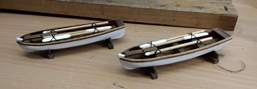

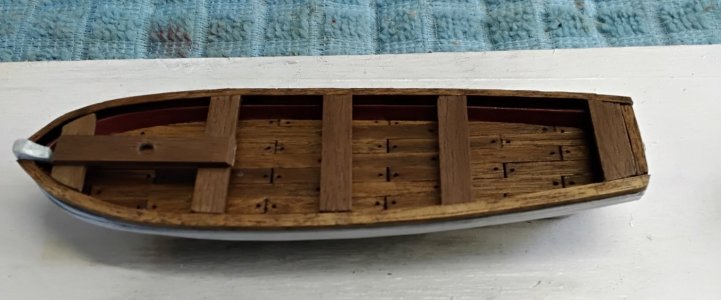

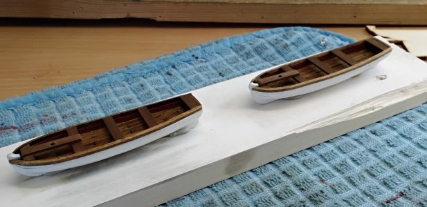

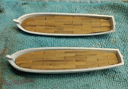

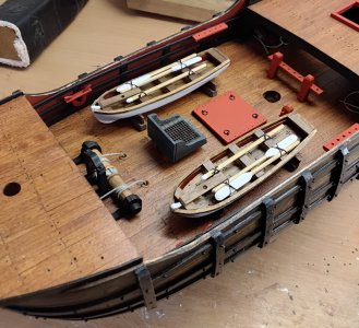

The longboats are white metal castings. Some clean-up necessary, but the definition is pretty good, so I will just spray them white. There needs to be a deck, so I made a card template ' -
Planking glued to the card -
Interiors painted, deck stained, gunwales roughly bent to shape -
Gunwales and thwarts (seats) fitted -
Oars and mast -
Stands and accessories fitted on the boats -
This is where they go on the deck -

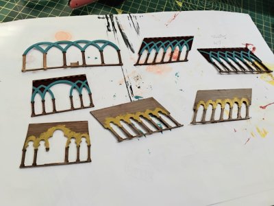

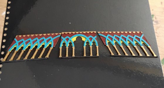

I have painted the external parts for the stern -
...but I don't like them, they are just too 'blingy'. These will be consigned to the 'might come in handy' box and I will go with some much simpler windows as per the full scale sailing reproduction.
Wow! I thought those external trim parts looked totally in-character. Will be interested to see what you come up with for replacements. The boats look great!
Thank you. I will be interested to see what I come up with as well! I had an hour on line searching for dolls house or war hammer style accessory windows, but no luck so far. Maybe the boss will let me use her Cricut machine if push comes to shove.
Blue pigment for paint was extremely difficult (and thus very expensive) to come by in the 15th -16th century. Unlikely to be used on such an ordinary ship as the Santa Maria. Change it to a medium to dark green and all will be OK.
