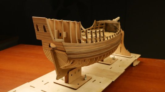

Doc... my point was... I don't understand why the kit has wale #14 setting 1mm lower (in a groove) than wales #16 and #20 (not in a groove)??
I agree with your diagnosis: the one wale was set into a groove to establish the vertical for everything that follows. This would be essential given the pre-spiled planking that comes with Pavel's kits (including this one?)...
I was planning on leveling wale #14 as not sure my groove is uniform. Guess now I'll level all 3 wales to the same height. Will make a little jig with sandpaper at the bottom (set in a groove) to make all the same.
Starting on planking the transom now.
Looking at a photo from Pavel's link, the planking edges are beveled... How do I bevel the transom and hull planks uniformly?
Wait... I just remembered I had done this before with a tiny 'round-over' bit. The problem is I did this with a CNC machine that I not longer have. I believe the tiny round-over bits only come a 1/4" shank and I can't use this with a dremel. Hmmm...
Pavel's SOS link Image from his post #83

Thank you Grant and everyone. I'm back to the wale #14 set into a groove. Wales #16 and #20 are not set into grooves. I have removed wale #14 I had earlier glued into the groove. Deciding whether to fill in the groove so #14 will match the height of #16 and #20. Or to sand #16/#20 down to the height of #14 (set in a groove) before installing.

I had removed the 1st layer of the 2 layer wale planks that I had previously installed. I still don't like the setup of placing one set of wales (2x2mm = 4mm height) in a groove that is about 1-1.2mm deep and 2 sets on top of the bulkhead. I'm thinking I'll place a 1.5 or so thick plank in the groove and gently sand it to the level of the bulkhead. That way all 3 wales will be the same height. Does this make any sense? Am I putting too much thought into this? Thoughts??
Looking at the above image I wish I wouldn't have installed the interior wall (bulwark) per the kit and video instructions. One can see though the bulwark as there are spaces between the boards. The inside of the hull planking will be visible through this spacing. Now I will have to try to remember to airbrush the inside of these planking pieces before installing them on the hull. Had I not already put the bulkheads in place I would have been able to airbrush the interior of the hull planks aftger they were installed.

I cut 2 strips from basswood 5.6x1.5mm to fill the groove where the wale #14 goes. This will bring the first wale up to the level of the next two wales. I wetted the wood, bent it and then applied heat to form the curve at the bow. I had cut a small scrap to match the curve of the bow.
The first piece of basswood is glued in place. it stands slightly above the surface of the bulkheads. I had cut the basswood strip 1.5mm deep as some of the grooves are deeper than others and I wanted make sure there was wood above the edge of the bulkhead on every bulkhead..
Will sand the basswood level with each bulkhead, then glue the first of two strips of the wale on top of the basswood, ensuring the wale matches the curve of the groove.
The three wales are each made up by gluing a 2mm thick walnut piece on top of another 2mm thick walnut piece. This makes a 4mm thick wale, which would be tough to bend on its own. The regular hull planks are 2mm thick.
