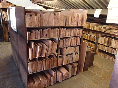

What I meant with as large as possible - as thick as possible - my first scouting for wood came up with several dealers on for instance ebay who sell steamed and already planed wood planks - not sure if that is the corect way to name it :) but it is already planed to a uniform thickness of 2 3 6 and even 8cm thick.
like this
not sure if that is way more expensive than buying the wood in planks like you showed but at least this seller for instance made sure all the wood you buy can be actually used, No insects no cracks and knots and although a bit harder right now due to corona you can pick it out yourself.
I for instance have no clue yet what I would need for the build in volume or kg's for a ship like the bonhomme 1:48 scale. The ancre book is on it's way so I have not had the time yet to study the drawings and make educated guesses yet.
as for tools I have a proxxon dsh/e scrollsaw and a proxxon TG250E disc sander. Good tip about the oscillating sander especially for the inside of the ribs this will come in very handy i assume.
But to get back to the saw - would a band saw or a circular saw be better if i purchased wood like pictured above?
Like said I like a bandsaw because it's versatile but if it's really hard to make straight cuts then I guess i'd be better off with a tablesaw although the cuts will be much wider and this have more loss of wood.

So you are already well equipped ......
Your photo is showing a very well-sorted timber dealer - prepared in different thickness and already dry - Do you have direct access to this dealer? Maybe it is also an interesting address for other members, so maybe you could post a link.....

Hi Uwe,
The picture is from de arnhrmse fijnhouthandel, see the link below. They do have a hobby attic, selling the smaller pieces for the hobbyist.

Many Thanks for the links - what a great shop
The photo you showed is all steamed pear !!!

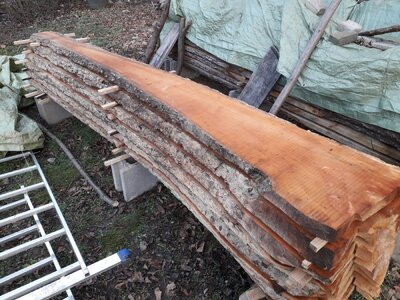

I purchased a big high quality bandsaw last year, this as I bought 11 pear tree trunks at only €3,- per tree. I should say with a high quality band saw you can saw rather flat billets, depending on the size of the blade you use on the saw. The bigger the blade the more straight the cut. But offcoure I need to plane it afterwards on my proxxon thicknesser.
I you buy the pre planed wood billets I think the table saw will be sufficient, this as a quality band saw is much more expensive.
The positive thing actually of having your own band saw is you can work with your own wood, I have now almost 1m3 of unsteamed pear wood which I can saw tailored for the project I need.
I even use maple coming from my own garden now.
