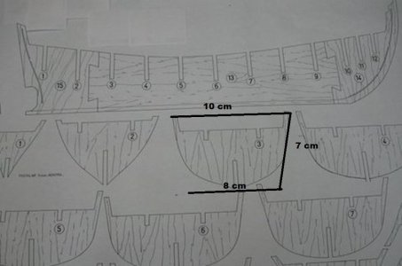

@AllanKP69 Example: I've placed the numbers randomly. I don't know the scale, but I want to make it at a 1:72 scale. Can I find the scale of the piece using the measurements? (excuse for my basic english sometimes use to translate)
Yes, if it's possible to find any data on the ship. Not if it's a made-up model and the plan is fictitious.@AllanKP69 This has been bothering me for a long time. Let's say I find a plan, either online or by hand, and I don't know its scale. Can we derive a scale based on the length of any part of the plan? Perhaps I'm confusing things too much, and if so, please forgive me.

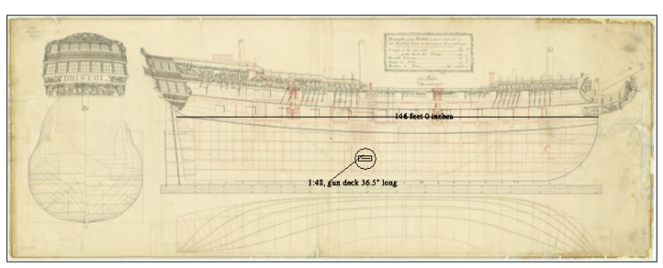

Here is one example of how it can be done, in this case HMS Bristol (50) 1775. There are basic dimensions at the top of the drawing and a scale under the keel in feet and inches. Below I download the drawing and scaled to full size with a gundeck length of 146 feet. In the circle is the same drawing reduced to 1:48 with a gun deck 36.5" long. Once done, delete the full size plan from the drawing and you have a 1:48 scale version that you can print in pieces or take to a printer that can do the scaled drawing. It will be about 56 inches long, For smaller scales it is the same principal. Even a simple CAD program can do this and I think there are still some free ones on line.what I could do if I ever reach the stage of building from scratch and encounter such a problem
