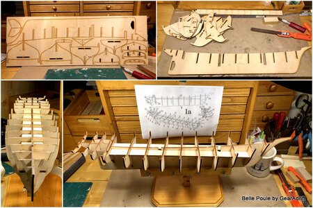

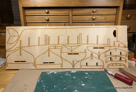

Picked this kit kit up over a year ago. Like most other folks, the pandemic postponed a lot of stuff including our retirement move. But we’re here now and I’m just about finished setting up my workspace so its about time to get started.
This is a nice kit. Lots of laser cut parts from quality wood, good looking blocks and line, some very nice resin castings, and very good instructions and plan sheets. The box was nicely packed and parts inventory was complete.
Thanks all for taking time to look and comment.
Regards,
Buddy

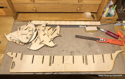

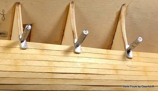

Getting underway...
Had a minor warp in the keel piece. Dampened one side and weighed it down with opposite curve overnight. Corrected. Dry fitting is next.
I'm quite pleased with the quality of materials and engineering in this kit.
Thanks y'all for taking time to look and comment.
Regards,
Buddy

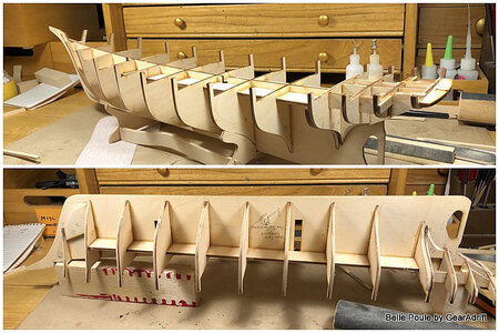

Hull framing has gone along quite nicely. All the parts were very accurately cut and dry-fitted with a minimum of trimming and/or sanding. Assembled the hull framing using Titebond to secure everything and set it up overnight to cure.

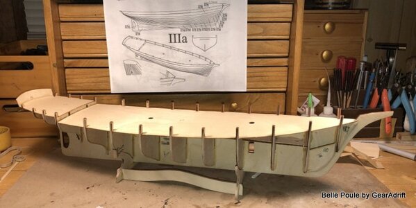

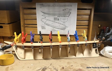

More fairing bulkheads. Install the sub-decking and stern piece. Sub-deck required a bit of fitting/trimming/sanding but nothing major.
The laser cutting is likely more accurate than my assembly technique...
and more sanding....

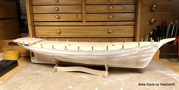

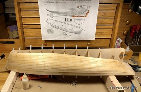

Finished fairing the bulkheads. Began first layer of planking.
Hull has 2 complete layers of planking and one partial layer. Planks are laser cut.
I have planked one POB hull previously, Model Shipways Fair American, and it wasn’t pretty… I think I ended up with more filler than actual wood…
Thanks All for the comments and “likes.”
Regards,
Buddy
