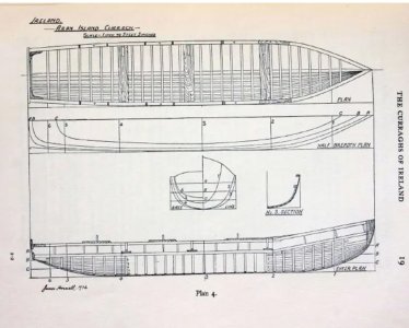

The design I have chosen to use is from the Arran Islands and I enclose a schematic from Hornell's article here. First I will need to research the materials used in the 6th century and how this boat would have been built, determine a scale, and begin building a "mold." Curraghs are built "by eye," as the Irish say, and so there is a great deal of variation between boats of the same sort. Since I cannot lay out the shape of my model on the seashore, I will need to build a mold over which I can actually build the boat. (This is very similar to how many lifeboats are built in large models such as the Beagle and the Bounty.)

I have built two currach models. The first was a model of Brendan’s currach, and was the subject of three articles published in the Model Ship Builder Journal in March, April, and May of 2013. The second was a model of Columba’s currach, from the same century, and this one was the subject of a NRJ article (Vol 66, No. 2, 2021). Each of these models was built the way these boats were actually constructed - double gunwale first, curved ribs added, longitudinal stringers tied to the ribs, and leather covering added over the completed frame. If you build your model this way, there is really no need for a mold. Manipulating the curved ribs, which were inserted into the lower gunwale, provided the native currach builders with a way of “fairing” the currach frame by eye, along with the stringers that serve a purpose similar to the battens commonly used to fair the stations in a plank-on-bulkhead model. I learned a lot from my Brendan model, and think that my subsequent Columba currach model described in the NRJ is the better one. I was able to get a copy of the Brendan plans from the estate of Colin Mudie, who drew them for Tim Severin’s reconstruction. If I can find them after all these years, I could send them to you by PM or by email. I purchased plans for the Columba currach from the Causeway Coast Maritime Heritage Group, and could send these to you as well, if you like. Best wishes for success, currachs are fascinating, time-tested boats that are a testament to the skills of early boatbuilders.
Seamus
I also used Hornell’s book as one of my references, very helpful in the details of construction. The Brendan and Columba currach replicas constructed by Severin and the CCMHG were 36’ in length, considerably larger than the ones pictured in Hornell’s book. If you use the plan you posted earlier in this blog, you might want to scale it up a bit. Let me know if/when you have questions during your build, I will be glad to share my experience in modeling curraghs.
Seamus

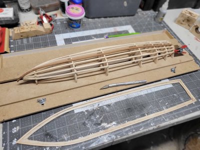

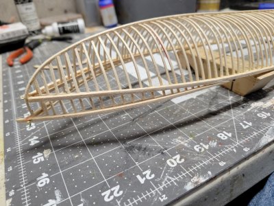

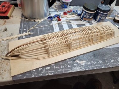

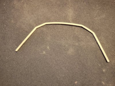

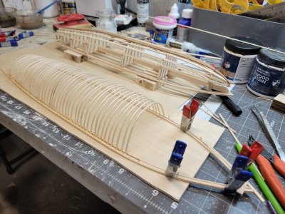

I decided on a scale of 1/24 which would result in a model about 18" long. First chore was to build the mold. Then I attached it to a base and added the 1/8" x 1/8" square dowel gunwales. I spaced the gunwale away from the mold with a 1/16" strip and then started adding the 1/16" x 1/16" square dowel frames. At this scale, lots of the frames break when placing them. I use both boiling water and a heated iron to bend them, but many times they break anyway. (Not really break, more like collapse. Any suggestions how to avoid this?)

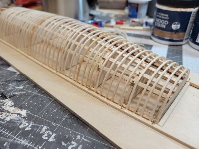

Figured a way to bend the frames without breaking them. First soak in hot water 1-2 minutes. Next bend carefully over a can or bottle of suitable size and hold 1-2 minutes letting the wood fibers stretch. Next shape the frame to its proper length and then glue outside edges while still wet. Once I got the length correct for each frame, it went along quickly.
Very interesting project and nice work! I was going to recommend bending the frames around some sort of cylinder (bottle, mug, etc) first to limit breakage, but looks like you figured that out already.

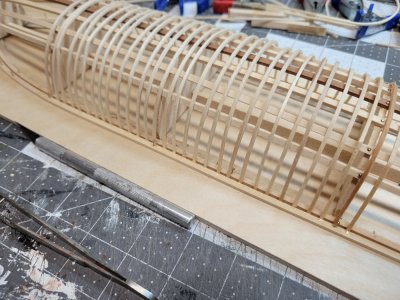

I figured the length and breadth and multiplied the frames (and the size of the frames) to get to scale. Actual size is about 35' long, scale size is 18" long, frames are 1/16" x 1/16" dowels, and spacing between frames is about 1/4 inch.

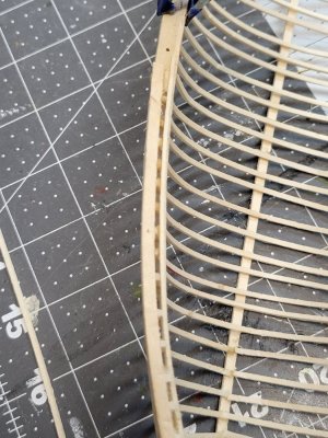

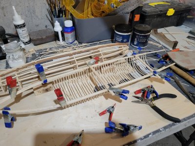

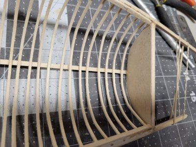

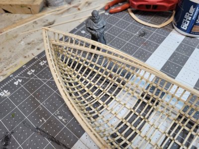

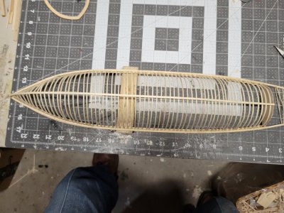

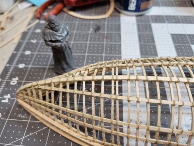

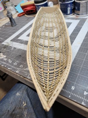

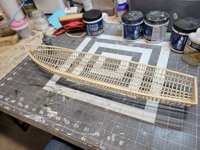

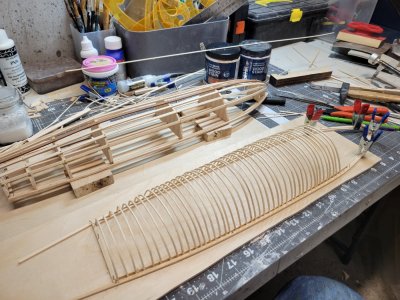

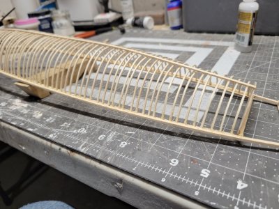

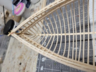

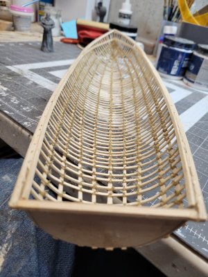

Finished up most of the framing today except for some sanding. The first photo shows the raised prow, the second the rear framing, the third an overview and the last two the prow and stern from inside. Many of the frames are not equally spaced, something I thought about correcting, but then decided to leave it as is. The Irish curragh builders worked "by eye" and at this scale I was forced to do the same. The imperfections help make it perfect for me.

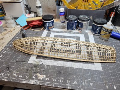

Finished tying the frames to the stringers. (Glad that's over!) Next some weathering and then will need to confront the "skins" issue. While the boat seems strong, it is very fragile. I worry that anything I might use to replicate cow hides will dry, contract and crush the model.

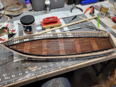

Weathered the frames and stringers a dark grey. For the most part, they won't be seen except inside the boat. Hoping the "skin" will be somewhat transparent enough to see the shadows through it. Added the floorboards. Next comes the thwarts.
