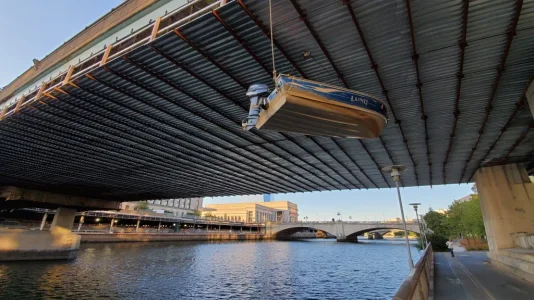

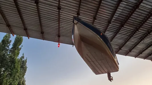

Background: Philadelphia (Pennsylvania U.S.) is bounded by the Schuylkill River (pronounced "Skoo-kill"), the Delaware River and Delaware Bay. The city has about 11 bridges and each time a bridge is inspected, repaired or painted, one sees a small boat hanging from the bridge work area. (Pics 6 & 7). I am told this is a requirement from OSHA. The Delaware River Port Authority calls this vessel a Rescue Dory, but based on my research about the different uses of dinghies and dories, I believe that the boat is actually a dinghy because it is not an ocean-going vessel. I'm calling it a rescue dinghy as such. The original Rescue Dinghy is a 12 foot standard aluminum-hulled utility boat from Lund, possibly their WC-12 model (Pic 18).
My small model boat club is doing a year-long project to build the "Philadelphia Navy" consisting of: the battleship U.S.S. New Jersey, the submarine U.S.S. Becuna, the cruiser U.S.S. Olympia (Admiral Dewey's flagship during the Battle of Manila Bay), the Moshulu 4-masted bark (originally a sister ship to the Spanish trainer Juan Sebastian Elcano), the tug Jupiter, an 8-man rowing skull, a 20-paddle dragon boat, and the Schuylkill Rescue Dinghy. Doing a scratch-build, I based the plans for the Rescue Dinghy on a kit from Midwest Products and am using wood stock from my shop.

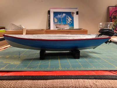

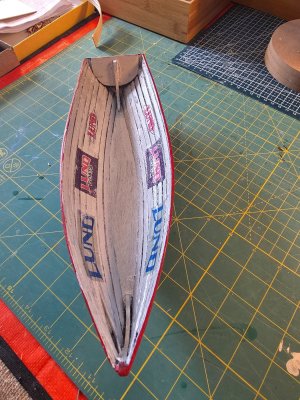

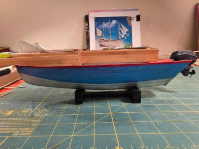

Well I think its time to put this project to bed! I finished building the hull to my Schuylkill River Rescue Dinghy. It came out so-so, and I may just cut my losses and start my next project.
My first issue was using 7-8 mm width planks, which several site members explained was too wide for this scale of build (1/16). THANK YOU CRISJACA! This was fine for planking until the wide planks made it impossible for me to get the fishtail transom to lay right. So if I want to finish the dinghy model I will have to fabricate a false transom to cover the mess I made of the transom. Too much work for a (sorta) failed build.
Next, I didn't have enough bass wood planks in my shop to finish the build and I ended up using balsa wood planks, and they clearly do not match that bass wood stock. Maybe this can be covered up when I stain the dinghy, or maybe not. Again, maybe time to move on.
Finally, an early mistake was not measuring the length of the bow stem properly. This led me to start the planking without enough taper at the bow. By the time I started properly to taper the planks at the bow, the damage had been done.

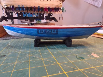

Another blizzard in Philadelphia, another project in the books. I was able to finish off the Schuylkill River Rescue Dinghy with a fresh paint job, a false transom, and some decals from the Lund Boat company. I'm still waiting on my 1/12 scale outboard motor, which should arrive in a few days. The decals were new for me and I wasn't able to get a clear Lund logo on the hull. I tried a number of different Lund logos and they are inside the hull for now.
As I mentioned above, this was my first scratch build and I learned alot. Now I am glad I can put this Schuylkill Rescue Dinghy on my shelf and move on.
