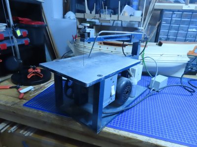

Hi Roger
I posted the Proxxon. It isn't for small places, as suggested. Is as big and heavy as a Delta, just a little less bulky on its design. And does a fantastic job on this hobby. I never used the Delta, because I got the Proxxon. It was one or the other. So I can't compare by own experience. The negative part of the Proxxon tool and any other tool coming from EU are the new taxes (tariffs). In that case a Delta, due to quality, as explained, and final price, will be a better option. I paid my proxxon, ~4 years ago something around $400. It wasn't cheap at all.
Cheers
Daniel
PS: And does not jump or walk at all :-) . It is very heavy.

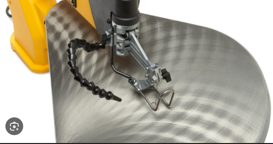

The knob tightening the drop foot tends to loosen with the vibration of the saw, but when tightened up, can make it difficult to move stock through the blade. This is further complicated because the throat plate is just slightly lower than the surface of the work table. Stock tends to get caught on the higher edge of the work table. The drop foot must then be loosened to proceed and hastily retightened once the stock is past the surface discrepancy. Makes accurate cuts sometimes a challenge.
Perhaps I should have bought a bandsaw instead.
I could see where that would be frustrating. The DeWalt has no throat plate - only a small hole in the cast iron table through which the blade passes. There is no need for a throat plate because the center of rotation of the tilting table is right at the hole. I've already mentioned that there is no vibration - a nickel balances on its edge on the saw's table with the saw at full speed. As for the hold-down, it is the first thing that 99% of all scroll sawyers remove from their machines. It gets in the way of seeing your cut line and introduces drag on the workpiece. With the proper blade and technique, it is not needed.
I don’t know if this is possible since I have never seen the saw but I sometimes replace control knobs, thumb screws, etc with socket headed cap screws that can be tightened with an Allen wrench. I did this with my bandsaw. I would also shim up the throat plate so that work does not catch. This can be as simple as gluing layers of paper to the backside.
None of this excuses shoddy workmanship by Rikon, but could help you to make this tool usable.
