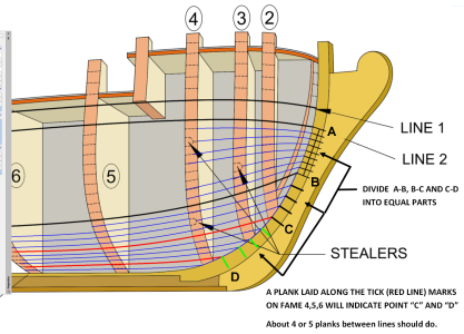

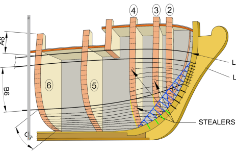

I am having troubles figuring out the plank widths at the bow.
page 20 of your PDF. The stem tick marks at band b and c especially.
I understand where to lay tick strips along the frames between the band lines on the frame from frame 2 on that is no issue.
In figure 12c How do I find the length (band width) along the stem to know where to put my tick marks? There is no frame to reference at that location. I hope this makes sense. I've read many post here and I am just having a brain fart on how it is done. I've watched many videos but no one really explains the aspect of it. even chucks video is allusive on how. What would be ultimate is if you or someone else could make a short video and post it for me as I am more of a visual kind of guy.

Hi Les.
I don't think there is an absolute mathematical (or 2d graphical) way of determining this.
There has to be a bit of "eyeballing" or feel to get the planks mated to the stem piece.
The planks tend to narrow above the line dividing the upper and lower belts and widen somewhat below.
The widening at the stern post is sometimes quite pronounced.
You can take this dividing of the planks into belts further at the bow and stern. this will help you determine the "tick" points on the stem and stern posts.
Lay a plank along the tick marks (in this example) on frames 3,4,5 and allow it to bend over to the stem. This will give you a tick mark there.
Do this every 5 planks or so. Then divide the distance between into the respective number of planks.
Hope this helps.
Regards

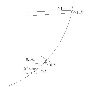

I may be wrong as I see no reason for eyeballing but whatever works for any individual is the way to go. Trace the area of the bow from the plans and divided the length of the line by the number of strakes. With the curve at the rabbet at the stem, small segments can be used to get the total length of the line.

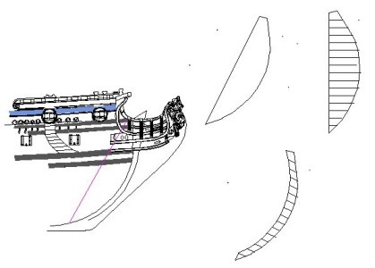

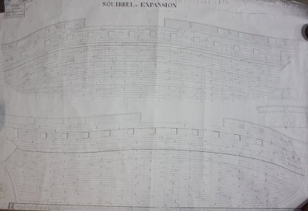

Planking expansion drawings such as the one in post #21 above are best if available but if not this can be done on our own using the profile drawing. Please keep in mind the template sketches are rough but hopefully will show the idea. The last sketch should be the width of the stem in front of the rabbet so it lays flat on the stem.

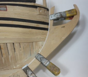

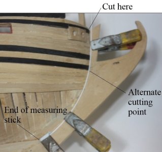

Thinking more about methods that I have tried, some may like the following method. Why I never thought of this before is beyond me, but I will be trying it in the future. If anyone does try it I would love to hear/see how it goes, both the plusses and minuses.
Using a very small piece of square stock (1 or 2mm square), or a plastic strip, clamp it to the stem so it follows the curve. Cut it at the top of the stem and measure the full length. Divide the length (this happens to be 124mm) by the number of strakes and you will have the breadth at the stem. They can then be marked with a sharp marker or pencil if wood is used. To minimize cumulative error, use bands of 4 or 6 or even 8 strakes then divide appropriately. For example, If there are 40 strakes, each will be 3.1mm. Each band could be 12.4mm or 28.8mm or whatever the builder chooses.. Once these are marked off on the hull, if there is a slight error, it can be accounted for on the next band to be planked.

I think I did not communicate this well. I was writing about the length of the measuring stick, in the case of the photo, the white plastic piece that follows the rabbet at the stem. Once clamped in place I cut it at the top of the upper most plank. It has nothing to do we the ship aft of the boxing joint of the keel.
Obviously the wales will have an effect, especially if top and butt or anchor stock, but in that case, the same principal can be used for measuring from the bottom of the wales to the garboard strake. I like to install the garboard sometimes one more strake before attempting to line out the run of the planking.
Hope the below explains things more clearly. Once the measuring material is clamped in place, cut it where it lines up with the top of the uppermost plank strake (or from the bottom of the wales. Measure the length of the stick and divide by the number of strakes.
You cannot simply divide the length A-D into equal parts. Assuming frames 4,5,6 are divided correctly and frames 2,3 ignored, here is a guess at what the result is.
It does not work because the edge of the stem is in a different plane to the frames.
If frames 2,3,4 are ignored the lines look OK but in practice you will find the planks cupping over those frames. (lower edge protruding or not sitting on the frame).
Dividing the distance A-D into smaller lengths is a good approximation, but determining where these sections or bands are depends on the shape of the frames.
At the bow the frame can go from convex to concave as it approaches the keel or the stem so the planks tend to widen as they meet the stem lower down. keeping this in mind the best way of finding these points on the stem is with a riband or thin plank to follow the curve of the hull to the stem and then mark those points on the stem.
The sections between can then be divided equally. This is not entirely accurate but it is more than adequate for model building. This is what I described in #28.
They are indicated on this image by the thin black lines, the thick black lines and the green lines.
Regards
