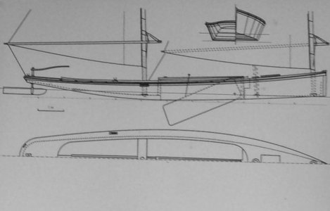

One, would, therefore, think that someone would offer a kit that captures the graceful lines of this remarkable craft. A drawing of a New Haven Sharpie is included below. Such is not the case. There is a Midwest kit of a Sharpie schooner, and the Nautical Research Guild offers plans and instructions for a Generic East Coast Sharpie on their website. Sharpie schooners are not nearly as attractive as the original New Haven built craft and the nicest thing that I can say about the NRG’s craft is that “they certainly succeeded in making it generic!”

The original classic sharpie is the developed in New Haven for oyster tonging. They were half decked open boats with no skeg in the stern and they had a balanced rudder. For comparison see the drawing in my post #1 above.
The design was so successful that it has been adapted and modified ever since. It should come as no surprise that the use of plywood as a marine construction has resulted in the sharpie design being a favorite for home builders resulting in my opinion in some very ugly boats.
According to Chapelle, the Sharpie may or may not have influenced building flat bottom and later Vee bottom boats on Chesapeake Bay. Another scholar argues not very convincingly that the reseeding of depleted oyster beds with oysters from Chesapeake Bay brought flat bottomed boat construction north to New Haven.

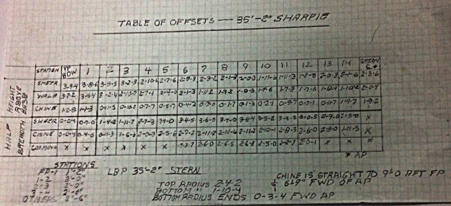

Chapelle’s small craft book includes an Appendix that includes tables of offsets for selected boats in the book. We are fortunate that this includes the Sharpie that will be modeled. In my next post I’ll explain the Table of Offsets and explain how it is used to create a lines drawing.
