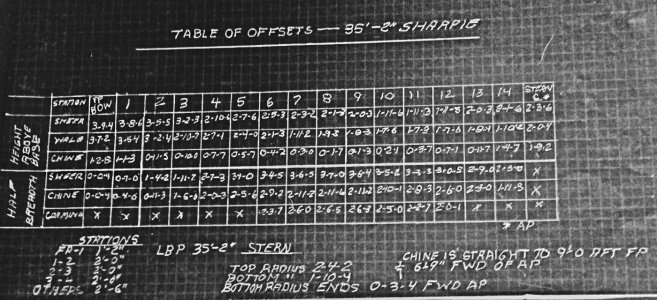

This lesson deals with the Table of Offsets. In his excellent book, American Small Sailing Craft, Howard Chapelle includes drawings for half a dozen or so Sharpies. One in particular Figure 41 caught my attention it has the lean hull lines and circular stern that I wanted to represent in my model. While I could order this drawing from the Smithsonian, I chose to make my own and Chapelle provides the means to do so.
His book includes an appendix with tables of offsets for selected vessels in his book including the Figure 41 sharpie. A Table of Offsets is a digital description of the vessel’s hull form.

Across the top of the page are numbers 1-14 representing stations on the lines drawing and we will make a mod fr each station. Down the side, are two major categories: Height Above Base Line and Half Breadths. These are further divided:
Height above base line: Sheer, Wale , and Chine (we will ignore wale for the time being)
Half breadrh: Sheer, Chine and foaming
A box occurs at the intersection of each horizontal and vertical column. Numbers given in feet, inches and eights represent the distance from centerline or baseline at t applicable lines drawing station.
Example: station 6
Sheer
Box 3-2-5
The sheer line is 3ft, 2-5/8” from the vesse’s centerline @ station 6.

Roger, you did just fine.. I have been playing with these and it is not hard.. there is a simple video here that explains what you did here:
