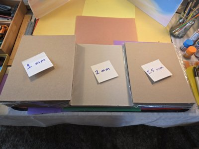

4. Cardboard, chip board, Foamcore, or hardcover book covers, in 1mm, 2mm and 2.5 mm. When needed, the paper cardstock can be combined to thicknesses of 4 mm to 8 mm. Above 8 mm and you may want to use balsa wood.

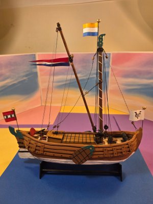

Here are a few pics of where I am now. I am building my Smalschip before 1700 when the Prinzenvlag (House of Orange) would have been used. She is also sailing out of Amsterdam, so she flies the flag of Amsterdam. I just have to finish the skeleton rigging and add some scale figurines and then I should be done.

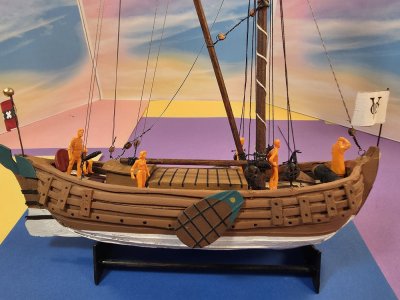

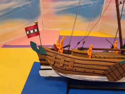

The leeboards gave me a bit of a problem because I kept going back and forth between fabricating them from card stock or using 1-2mm bass wood for a grained look. In the end, I decided to build the leeboards from 3 sheets of 1 mm card stock washed with diluted Elmer's glue for strength.

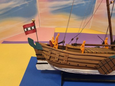

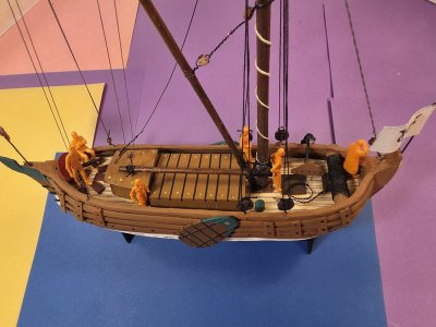

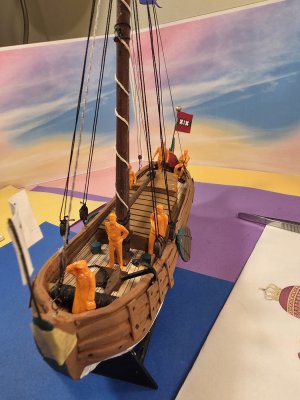

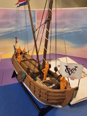

Mr. Hoving advises that all scale models should be populated with scale human figures to show off the dimensions of the ship and to give it a realistic look and feel. In his book he writes, "One of the advantages of adding figures is that the scale of the model suddenly becomes clear to the viewer, The human size works as a reference." "17th Century Dutch Ship Models," page 51.
It took a while to find miniature human figures in 1/48 or 1/50 scale. I tried different figures in 1/64, 1/50, 1/48 and 1/32 scales and am still waiting on another set of figurines in 1/48.

Not going to say much here. Just putting out pictures from the vast middle part of this build, in between planking and rigging.

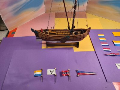

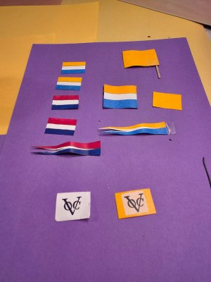

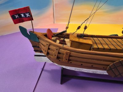

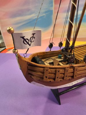

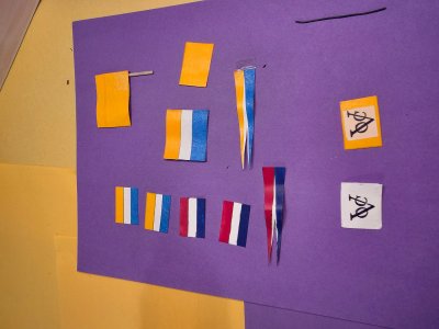

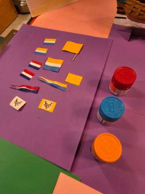

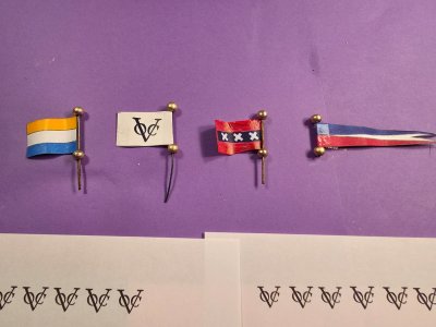

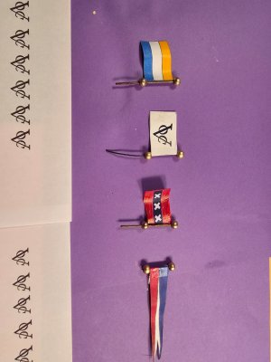

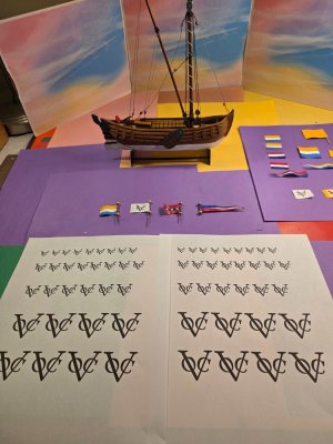

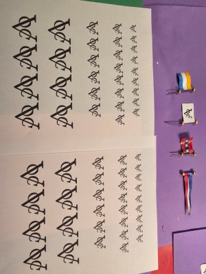

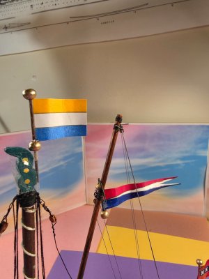

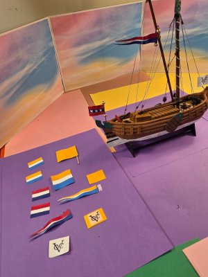

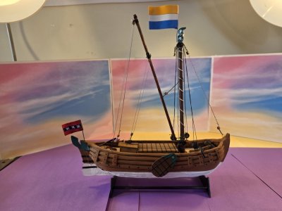

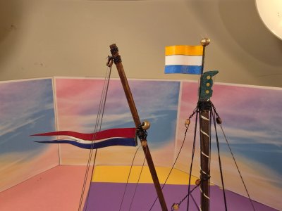

And at this point, I started to think about what flags I would like to use. I did my research into the history of the flags of the Netherlands. If this ship were operating before 1765, it would have flown either the orange/white/blue flag of the Princes of Orange (the "Prinzenvlag") or the flag of the Seven Provinces, which would become a republic around 1800 (the red/white/blue "Statenvlag"). Another option is the complete orange standard of the House of Orange. I also wanted to represent her as allied with a particular province or city, so I chose to fly the flag of Amsterdam at the stern. I do like that the color orange is associated deeply in the hearts of Nederlanders, so I went with the Prinzenvlag and the triple-X flag of Amsterdam. I fabricated the Amsterdam flag using water-slide decals on 65 lb. cardstock. I fabricated the Prinzenvlag, Statenvlag, and Orange standard using 80 lb. cardstock and orange and blue painters' tape.

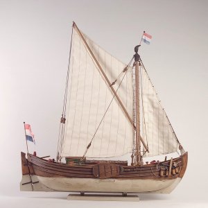

Here are some pictures of Smalschips:
And here is a new model kit from Noback Ship Models of the Smalschip based on Ab Hoving's designs in "17th Century Dutch Ship Models in Paper."

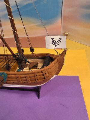

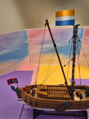

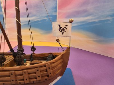

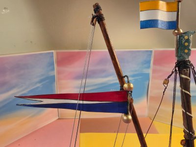

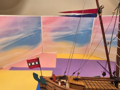

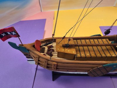

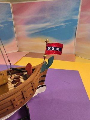

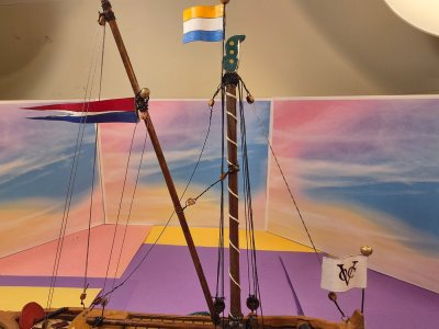

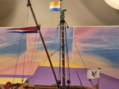

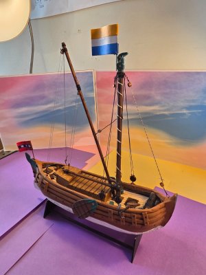

Ab -- I know you have said that the 17th century Dutch loved to fly their flags...in my Smalschip build, would the combination of the Prinzenvlag and the 3X Amsterdam flag be realistic before 1765? I know you also said that the 17th century Dutch enjoyed flying BIG flags, is my Prinzenvlag atop the mainmast in reasonable proportion? I'm thinking that I might also change the Prinzenvlag to a banner or pennant instead. Thank you again for all your guidance and inspiration!

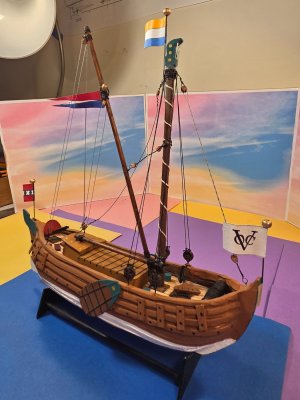

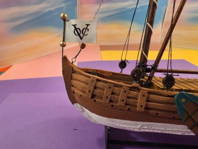

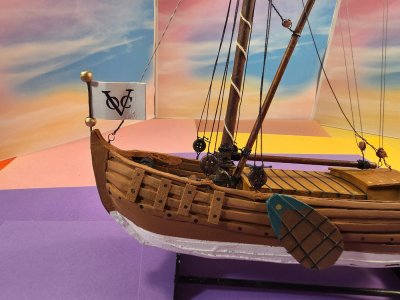

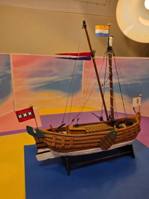

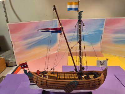

6. Build Log - "Smalschip" 17th-century Dutch inland cargo ship 1/48 scale, in paper cardstock from plans by Ab Hoving.

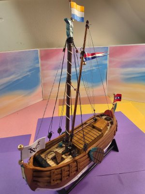

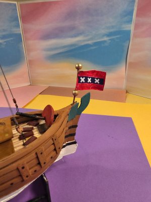

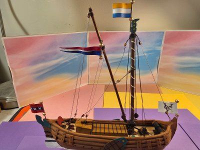

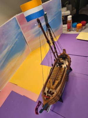

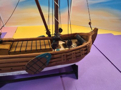

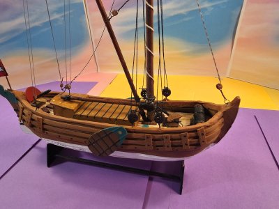

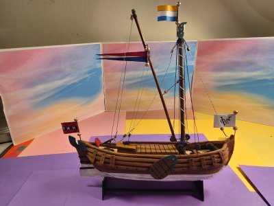

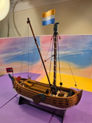

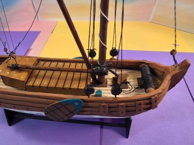

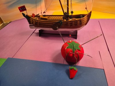

Rigging the Smalschip.,,

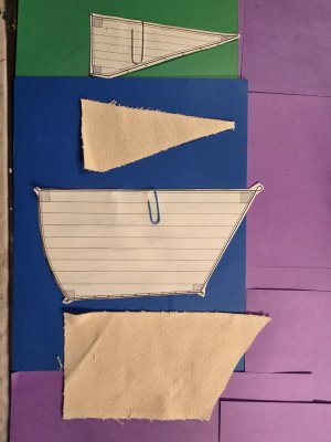

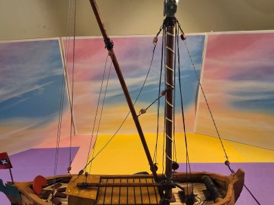

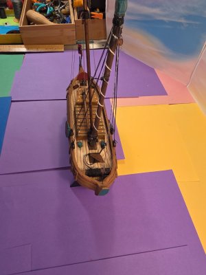

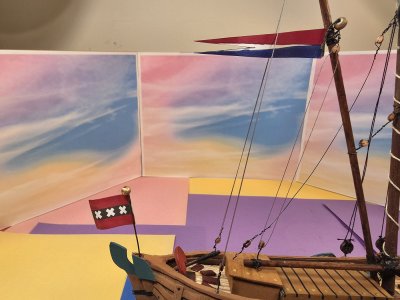

I had a couple of choices when it came to rigging the Smalschip. Ab Hoving's complete design plans have a fully rigged Smalschip with both a square mainsail and a gaff sail or jigger sail aft. He sews sails beautifully, but rigging is really one of my weak spots. My last fully rigged build, the Esmeralda, Chilean training ship had 19 sails 30 blocks and 4 staysails, damn near killed me!
So I also didn't want to leave a bare mast and boom, especially where the Dutch have turned rigging into an art form. But I don't think I need to get rigging skills out of this build. My main goal is to master the Ab Hoving paper cardstock building method.
I decided to do a "skeleton rigging" which is basically to attach every block that the vessel calls for, and run a standing rigging line through every block. I chose that route. I think a skeleton rigging can look realistic, give the ship some scale, and when the human figures are put back in the rigging will look in scale with the human figures.
So here are my rigging pics (more to come):
