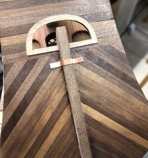

Hello @Bluebeard. I looked but it seems I did not take a picture. But it's not tricky. I simply wrapped the brass around the pin that I was using as the pintel. I then grabbed the brass strip (still wrapped on the pin) with a tweezers with very thin blades and bent out the brass arms to the left and right. I could then bend those arms to the rudder or the sternpost.
Several thoughts: the masters all solder these hinges but I have not tried that and was concerned I would make a mess of it at this scale. What you see in my log is the result after many failed attempts. What eventually won the day for me was finding/using brass that was thin enough that I could bend it with precision yet thick enough to hold its shape once I had bent it the way I wanted it. I ended up using 0.005 brass shim stock. I could cut it with a utility knife and it met these criteria. Once I started using this material the magic happened: nice tidy hinges with no soldering.
Hope this helps. I could recreate the process and take pictures if that would be better...

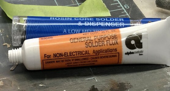

Here is what I used:

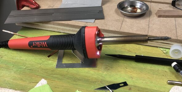

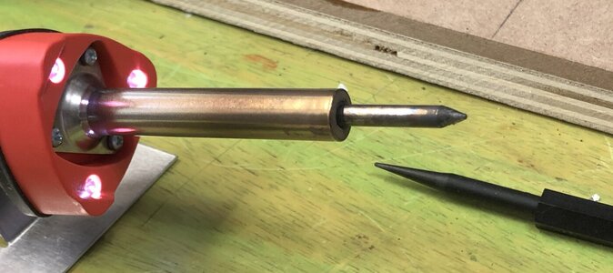

Fine tip soldering gun

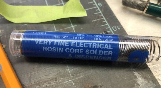

Fine resin core solder and liquid general purpose flux

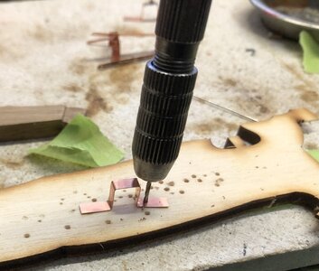

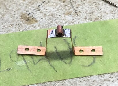

After receiving many suggestions from you guys, I finally learned an easy way to solder my rudder hinges.
To me it was a very frustrating thing to do until I saw the video that Jimsky sent me. I highly recommended to all because that’s how I learned what I’m about to show with all of the steps I took.
So here we go:
1st Step.
You should purchase a “Fine Tip” soldering gun. This one I bought from a True Value Store.

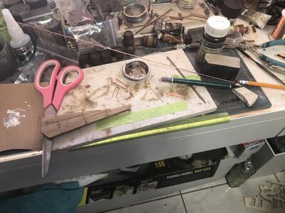

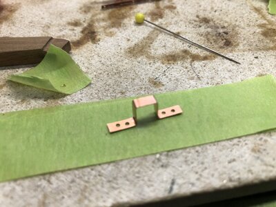

I start shaping my Gudgeons by copying the contour of the keel.
The Gudgeons are the easiest ones and will train you for the Pintles.
