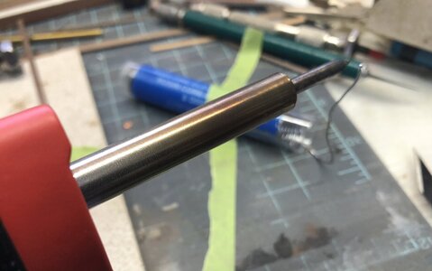

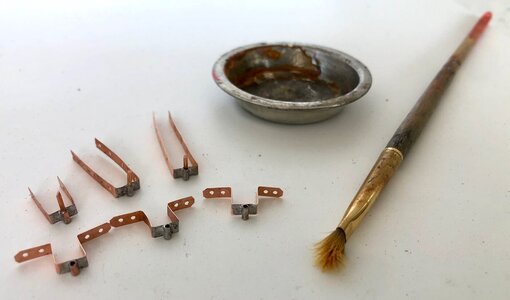

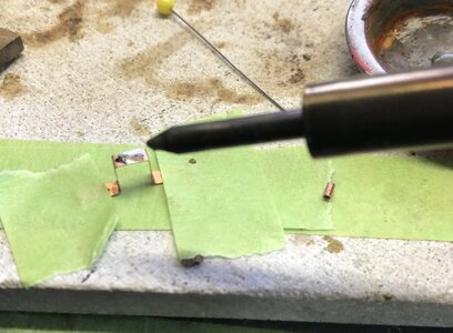

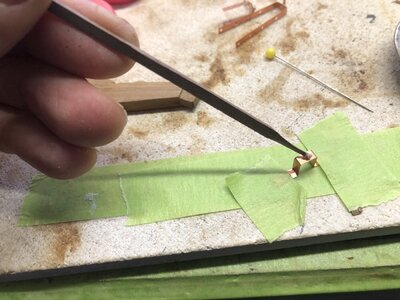

Now that your gun is hot and ready, touch the top of the gun to the flux and rapidly touch your solder.

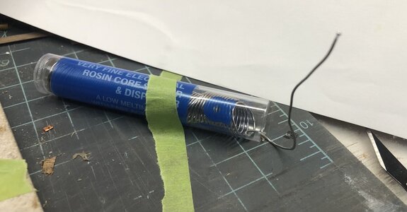

As you can see here I taped the soldering material to the table so it wouldn’t move.

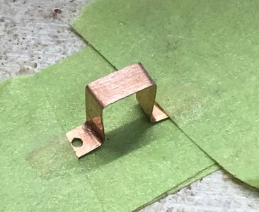

After I got just a bit of solder in the gun I pass it to the already fluxed hinge.

I like to thank PoulD who recommended to keep the tip of the gun always clean with a wet sponge or brass wool.

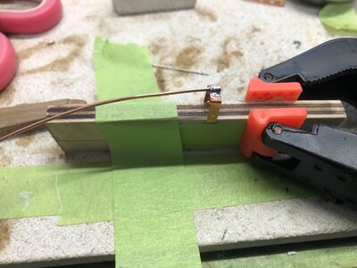

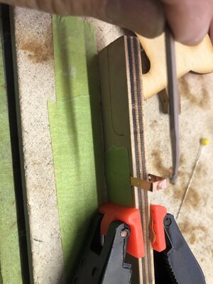

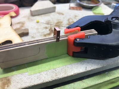

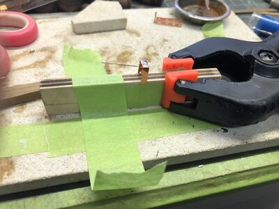

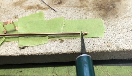

To join both the tubing and the hinges I tape the hinge it to a piece of ply so it won’t move.

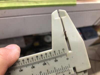

Now place the tubing on top of the hinge and apply the tip of the gun to the top of the tubing.

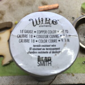

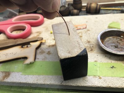

Just have long enough wire so you could hold it in place wile soldering.6DF2A4F4-B429-42FF-A339-1CB2C8E51CC5.jpegD98F7D3A-A367-4FAB-8E24-CDEEF0AEFA76.jpeg4B9FDE9D-99EE-4F74-837A-7CB71AD2EDDD.jpeg18260CFD-5627-4E67-82FE-8AEAA0D61F7B.jpeg

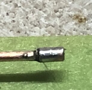

The Pintles are done with the same process.
Only difference will be to add a small amount of solder on the wire after is inserted in the tubing.
The solder will flow inside therefore giving the half of the Pintle.
After that, just place the tubbing with the wire on top of the hinge and solder.

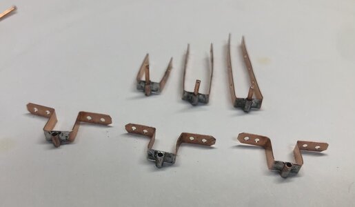

Then I cut the pin just a bit bigger than what is needed. I also cut off the tips of the Gudgeons only. This is something that it looked good to me, but don’t know if it is accurate. I didn’t cut off the tips of the Pintles dough....maybe I should...or someone could correct me on this.
B3B5AE29-1DA0-4B8E-89DE-9AC070E25A4A.jpeg42361493-1497-4D4F-B0DC-278B8B53E2AF.jpeg6D9E52C6-F8BA-484D-B9FC-88996E223E10.jpegF5930CB4-F5A6-4276-AA23-3EE4FC348A99.jpeg
Looks very good, Ken!! Now, once you grasp the basics, time to master it. To avoid solder spread all over the place, next time put solder on the tubing piece and then heat the 'T' bar part. Recall...solder will go where the highest heat is. This is called controlling the solder. Try it next time.
The excess solder you will have to scrape, depending on the blackening solution you will use, may not adhere to the solder. I guess you may need to experiment...

There are basically two types solder. Lead free (RoHS) solder requires higher temperatures ~215C and requires that all parts to be soldered are very clean and grease free. Lead based solder requires a lower temperature ~185C and is more forgiving on cleanness. You can also get by with a smaller soldering Iron with lead based solder. As for flux do not use acid based flux most of the paste type fluxes are acid based and needless to say the acid will cause issues with the models wood. Look for water based fluxes. In the photo the heavy coil of solder looks like 50/50 Plummer's solder. Don't even think about using it unless you are soldering copper pipe.

Using the principle that the solder will follow the flux, I use a paste type and apply it with a sharp toothpick end to only where I want solder to flow. Then I cut off a very small piece of the solder and with tweezers place it where I need the solder. Each piece needs to be firmly held in position so I use my small multi-arm device with the alligator clamps and additional clamps as need to grasp the parts and hole them in place without movement. OK . . now the flux followed by the solder piece are put in place and my small pointed soldering iron is applied gently touching the metal either under or beside it. The very small piece of solder quickly melts and goes where the flux was placed with very minimal overflow which makes cleanup very easy. Just my approach which I worked into from sloppy over soldered early attempts to the much smaller and cleaner result which will hopefully improve with more use. You may want to try this and see how it works for you. Good clamping is essential though so that things stay in place. Rich (PT-2)
