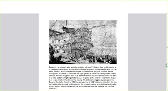

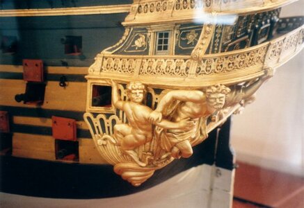

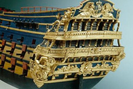

My firts guess would be Douphin Royal 1668. But in details are differences. The two figures under first balcony are too large and it lacks to figures at the sides top part of stern. Also it took part in the Battle of Beachy Head, so no Spanish traces
I didn't take your suggestion(bait;):)) in file description as it could be Royal Luis, as it has longer balconies similar to Dutch ships and much more figures
I digged little deeper in your file. Mabe it coulde be Douphin Royal after refit. They share some similarities but difference is too big

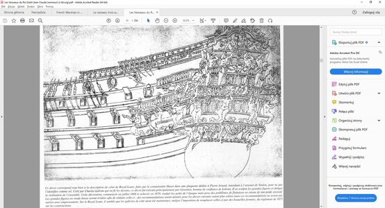

Oh it's getting hot:p. Royal Louis 1692. Many many similarities, especialy when we considered you called the file Royal Louis. As it was with DR 1668 it lacks figures

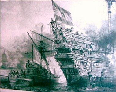

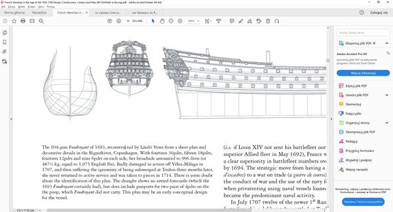

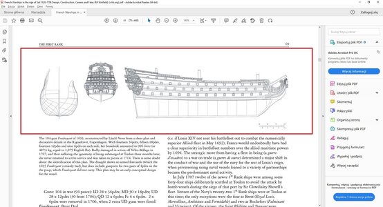

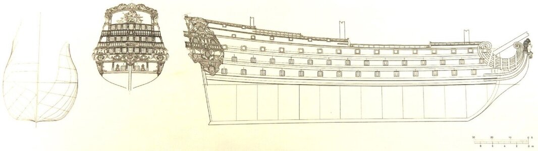

What I think it may be is The 104-gun Foudroyant of 1693.
Firstly almost perfect alining of stern decorations. Second it took part in action off Vélez-Málaga in 1707, so we have a trace of Spanish forces involved. I have no idea how they manged to put that flag on vessel. If I remember correctly English putted theirs above the captured ship. How Spanish flag menaged to be on french vesell is question to you:)
Do we play more or is it bingo?:)

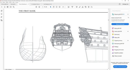

You have a good sense of investigation:) however some of your comparisons don't quite associate. The Dauphin royal you show initially is actually an academic piece representing a ship in the era of roughly 1725 to 1750 and has been named Dauphin Royal with no specific association with any of the real ships; it's simply a ''teaching'' model where one side of the hull can be fully opened to see the interior construction. the others are in the wrong era, except for the Foudroyant pic. You have made some good deductions on the fact that it probably is a french navy first rate ship of Louis XIV second navy which took shape right after the La Hougue disaster. So 1690+; to help advance that is the fact that there is no stern bottom balcony, which was part of the new construction rules. Now, as for the rest, I myself isn't sure of anything:) you compare this ship to the 1725 Foudroyant which came out later and I think it is a very good direction, the decor structure does resemble it quite a lot....But, the rear main board sculpting doesn't fit, and since those carvings would be carried over from one ship of a name to his successor, it rules out the 1693 Foudroyant. The flag itself may be a blue white and red with some crown and maybe the three ''fleur de lys'' emblem, which would make it french, but this is an interpretation of my part and it remains an enigma. I found something interesting while searching in my books; the Terrible was a first rate 2200 tons three decker also built in 1693 by Blaise Pangalo, who would later build the 1725 Foudroyant, and it is written that he based the whole Foudroyant on the Terrible, only adding a bit of length to it. more over, the artist by the name of Caffieri was responsible for both designs, as the bottom window surrounded by nimph busts, in an otherwise enclosed side gallery. the top flat window with the surrounding balcony also carries his signature. He was one of the most prolific artist beside Berain, who didn't have time for all of the design which needed to be made. The flag is my biggest issue, and I would need to look for more information on all of the 17th and 18th century naval flags of the french navy...There were a lot of them, some rarely seen....

I wrote after the book it was 1693 Foudroyant. Is it wrong described? On picture is from 1725?

The plan here is the Foudroyant, but the 1725 one:) it is possible however to see the similarities in the decor of the two, except for the main rear carving which is very different from the one on the artist drawing.....
As for making a model......Only from the pics it would be very hard since there is too much information missing; I guess it would be possible to find something to give a better overall picture of the 1725 Foudroyant

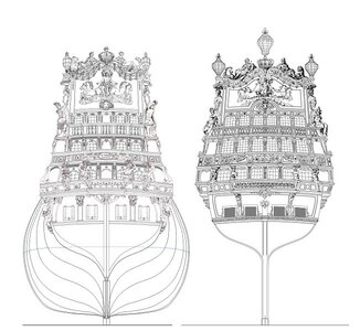

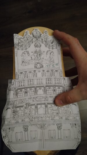

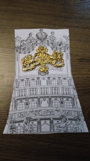

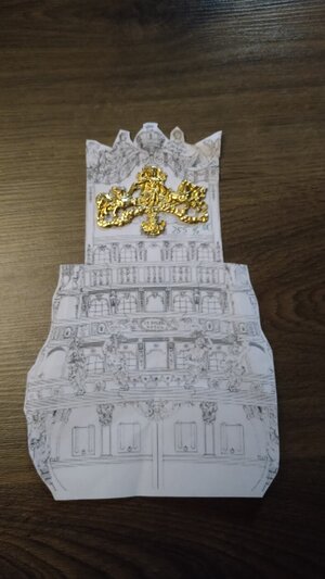

And more practical part of this discussion. Some time ago I bought unfinished Deagostini SR in cheap dirt price to do a little bashing with 3d print accesories.

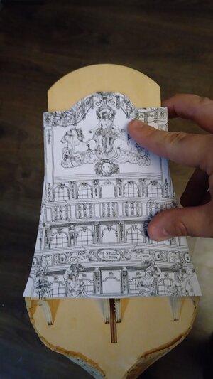

I printed and enlared one of your previose files . In one case to match the Apollo , in other to match the hull. Conclusion is: you just match the mold and don't look at balconies or go the Janos way scratch buliding
With the print matching mold you miss 9mm on both sides. It's the thicknes of plywood + 2mm of first layer of wood
Orginal file

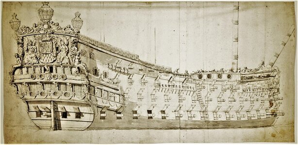

Hi:) so, first, the coat of arms you show is the one used on the Royal Duc:) ( look at the Van de Velde drawing).
Next, where will you be putting that lower balcony? becauseyou also have to fit the side galleries.....
This is the problem. With patern fitted to mold everything seems to be good proportions except side galleries loosing 9mm perside just to hull. And when I adjust widith to hull everything else looses proportion
My best solution is to simply lookfor the Heller Soleil royal parts which have the wanted decors ans statues, then measure and take photos of them to insert in a 3D printer...I have much of the in my spare parts......

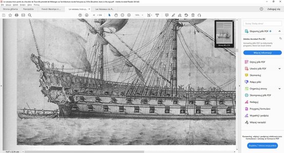

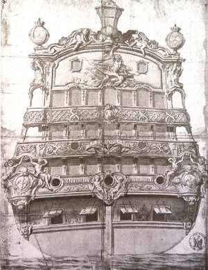

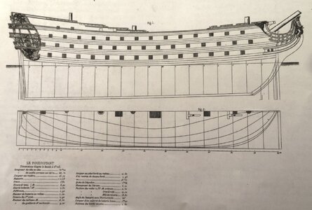

Next; I dug up some pics to compare the two different Foudroyants ( 1693 and 1723); I also read some interesting information. At the time of the great replacement builds, Hubac had already started his Foudroyant and was quite advanced before Pangalo was asked to replace the Soleil Royal; he already had a stern design which wasn't related to what we know for the Soleil Royal. Upon the name change at the time Pangalo was just starting his ship, he was told to keep the stern art he had (!) and an old drawing of Berain's SR stern was given to Hubac, therefore he had to tear down whatever was on the ship. So, here the question is: is the Pangalo ship design what will be refered in two subsequent ships? or the design of the 1723 Foudroyant different than the 1693 one? here are some pics....
So, the first one is labeled foudroyant 1693 version.....But it shouldn't have poop gun ports
The second one is supposed to be the 1723 version; it is longer and has the right number of gun ports, but it should also have poop gun ports
The third pic is the official 1723 drawing of the Foudroyant; be careful when you look as it isn't exactly the same as the other drawing

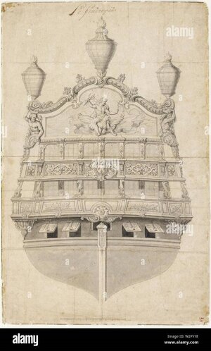

And finally, the fourth pic is said to be the 1693 Foudroyant(??) more likely the 1691 version if I attempt a guess. It would be the one that burned at La Hougue. It was somewhat a smaller three decker. Now, how does the drawing from the beginnig fit into this story? Or was it another ship completely? Like the 1692 Terrible, or the 1693 Triomphant, or its sibling the Agreable.....The rear stern sculpture seems to show an upright person either leanng on a sword or holding chains with two crouched or lying people at its feet...Could that be the stern decor of the 1693 Foudroyant initially Soleil Royal with a variation of the Royal Louis theme where the king sits on his throne holding chains with two crouched or lying people at its feet?
I do not have an answer for this, so if you have some information or pic which could help, please do so:)))
