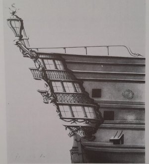

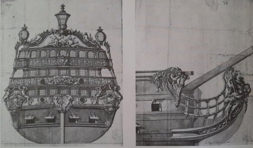

This is drew by Charles-Philippe Caffieri and represents Royal Louis, 1758
And those anonymous sketches are dated 1758

As for the stern gallery drawings I sent you, he confirms exactly what I wrote; the drawings are for the 1759 Royal Louis; there are two styles of ''bottle'' designs, and thatcould be because the one which is more ""Caffieri influenced'' was actually designed for the 1743 Royal Louis that burned before being put to water..
