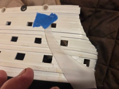

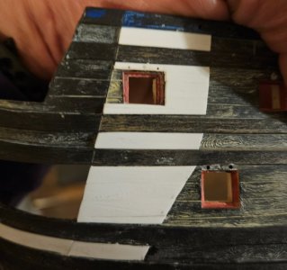

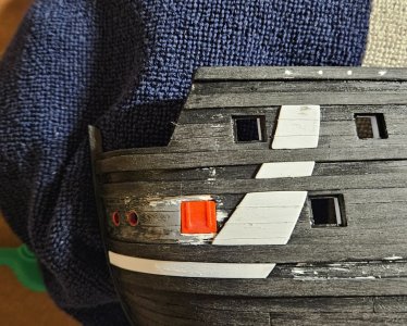

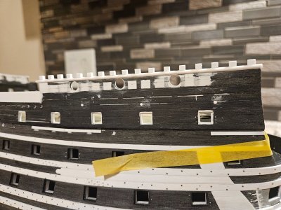

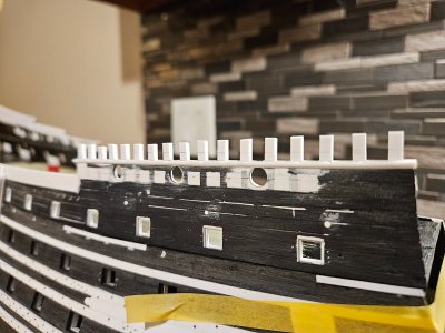

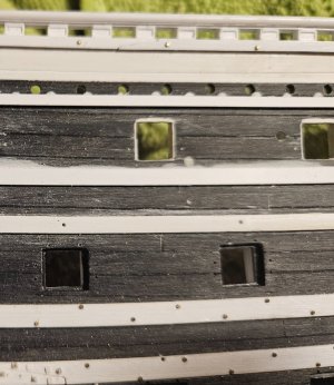

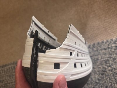

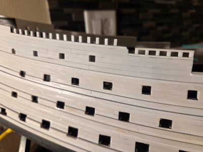

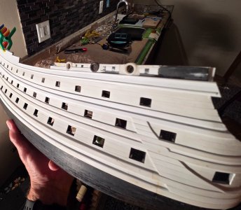

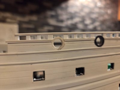

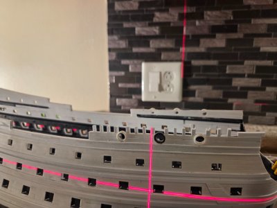

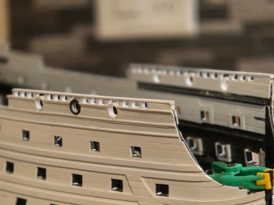

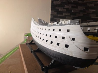

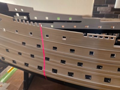

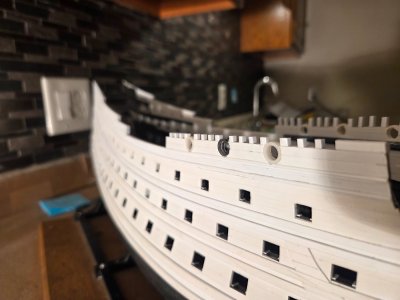

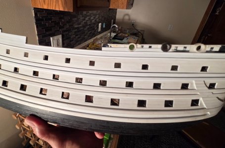

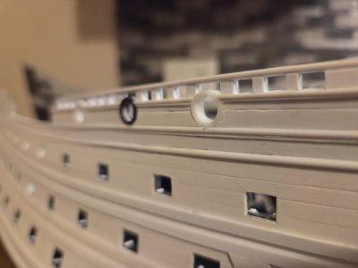

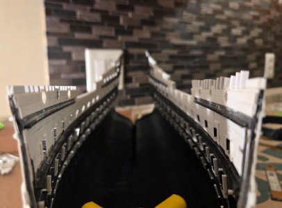

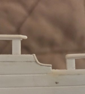

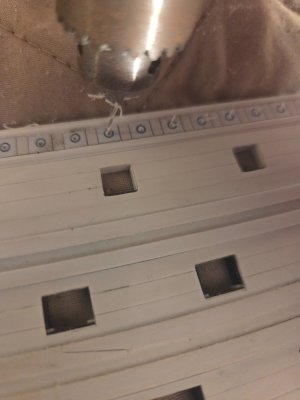

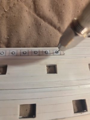

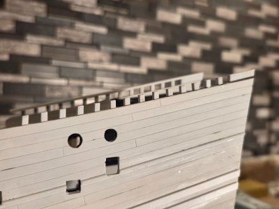

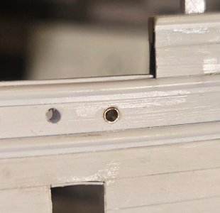

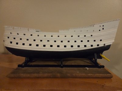

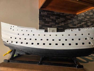

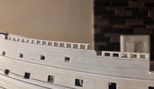

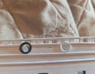

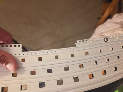

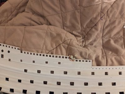

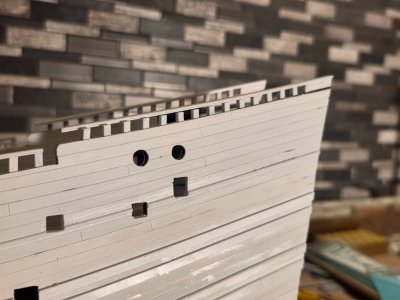

So, this is what SR1671.2 looks like now; what was the drift rail and all planking above have been stripped away for one reason.... raising the height at the waist by 1.5mm (already done in these pix) AND then repositioning the drift rail 1.5mm higher as well. The 1.5mm half-round was set on a 3.2mm wide strip - and all of the surrounding planks were 4.0mm wide. I couldn't have a 3.2mm wide plank ruining the view, so it was simply easier to remove the planks and replank again with all 4.0mm strips.

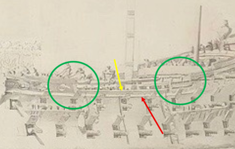

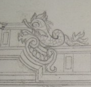

This VDV drawing of Royal Therese shows as well as any my goal after contemplating Marc's thoughts.
RED arrow idicates the lower drift rail.
Yellow arrow indicates the top drift rail/cap rail. The
green circles highlight the fore and aft ends of the waist. The lower drift rail runs the length of the ship; the top drift rail terminates at the aft end of the waist, sort of combining with a J-shaped hance piece. NOT running this rail all of the way aft to the Quarter Gallery will give me more real estate for the rear bulwark frieze/decorations extolling the virtues of Louis XIV and the French State. I am on the fence if the top rail will run forward to the bow, as period drawings seem to indicate a mix of 1) running to the bow, and 2) terminating at the fore end of the waist with another J-shaped hance piece. On some drawings, it seems that running the drift rail forward to the bow would cut across the gun ports? If you look at SR1671.2, I have room enough that the top drift rail would rune forward and be below the circular gun ports. Plenty of room.

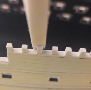

What this also meams is NO timberheads at the waist, as also shown by RT. I had been contemplating a design where I doubled the height of the waist timberheads to allow their cap rail to run seamlessly with the other rails. Those would be some pretty tall timberheads, almost three foot tall at scale,

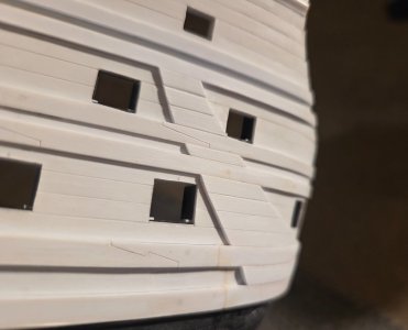

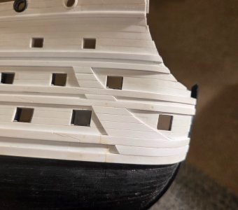

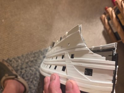

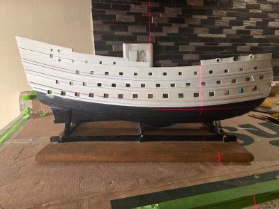

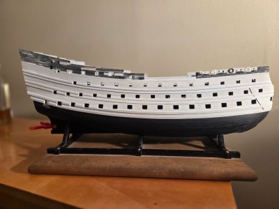

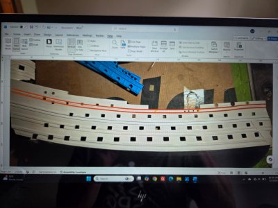

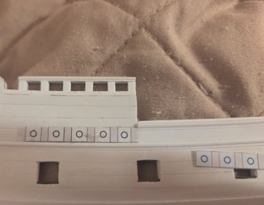

Finally, this bit of playing with Word gave me an idea to see what increasing the height at the waist and moving the drift rails up would do. Note that I added a few circular fighting holes at the waist and ran the top rail all of the way aft. This looks too congested to me, and also takes up a bit too much of the real estate. As noted earlier, the top rail will terminate at the aft end of the waist.
